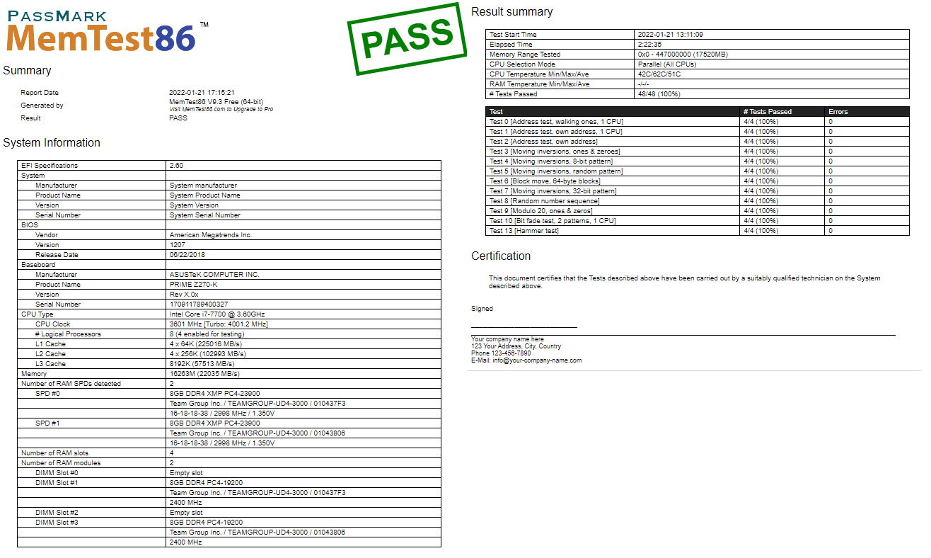

    Thank you for your help! I've updated the chipset and BIOS to the most recent versions, and just to be on the safe side I ran the MemTest86 regardless. I'll share the pastebin link to what I think are the results? And also the screen print of the results as well.
    https://pastebin.com/YhkhUN2u

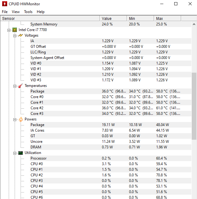

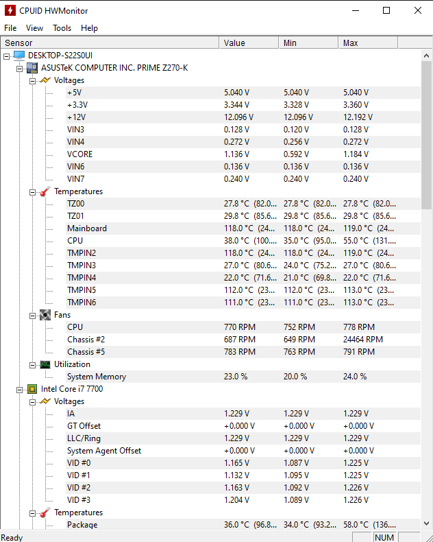

    Also, I have the program called CPUID HWMonitor which is showing very high temperatures on my Motherboard, however I've checked it physically with a Thermal Reading monitor and it's not overheating at all, and temps aren't reaching past 50 degrees C. I'm not sure if this is a sensor issue or a false reading or what. I've added screenprints of the program below.
