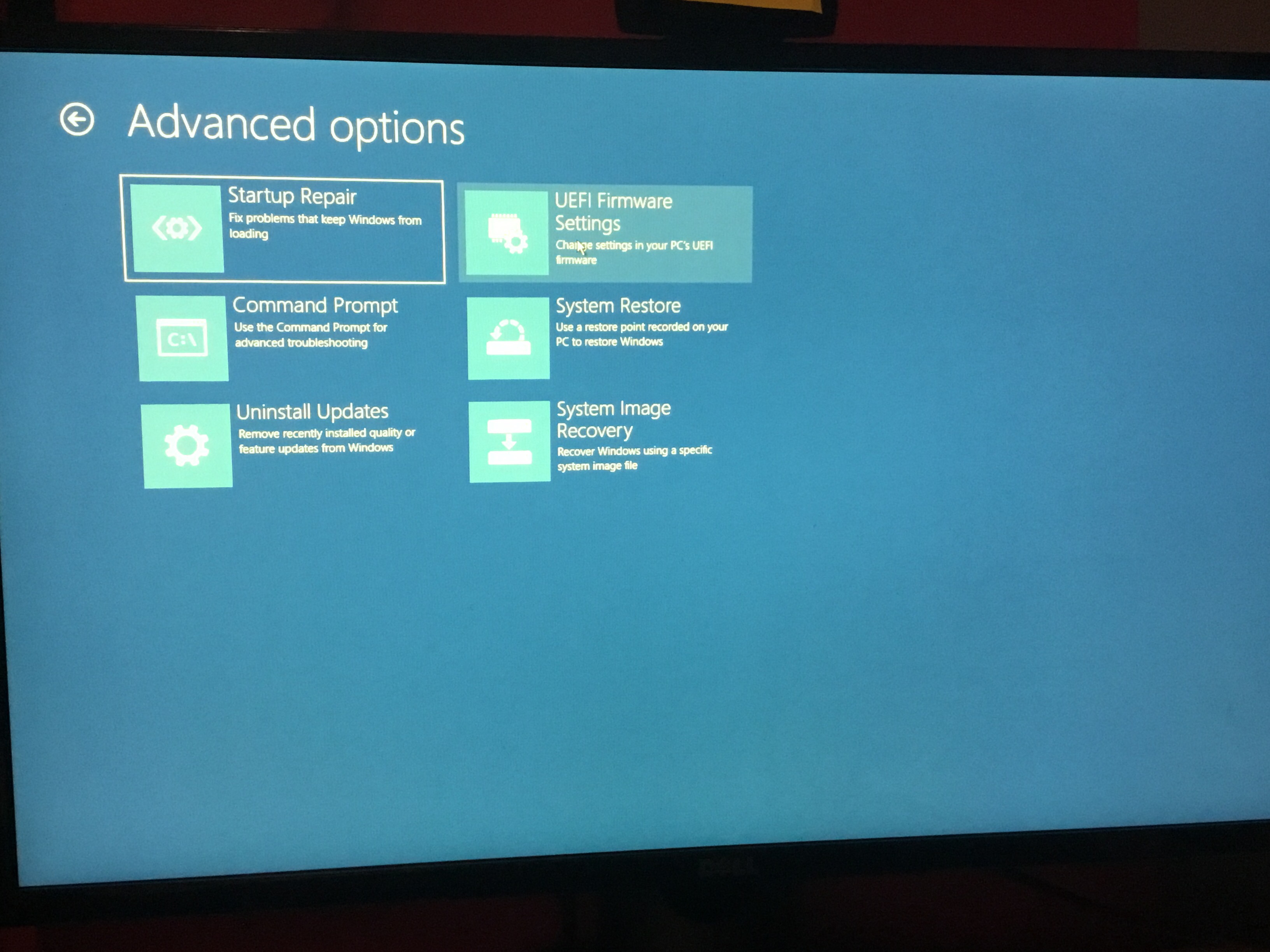

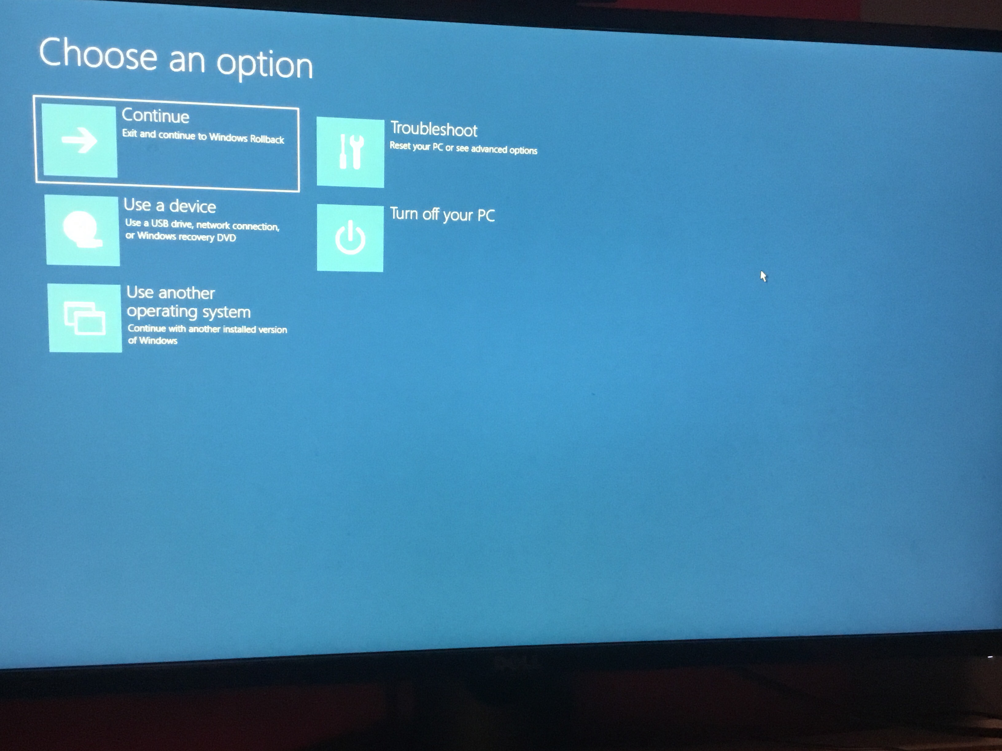

    For winRE issues, see attached images. There are no reset or startup settings options.

    What happens when you click on the Troubleshoot option in your second screenshot. It should not say that it has Reset available if it doesn't.
    Also on the same screenshot it shows Continue button has a roll back queued. Can you choose that? Is it a version Update roll back? You may need to do that.
