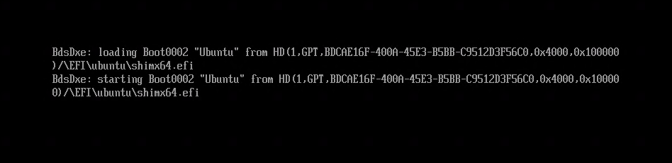

When I boot the resulting image using qemu locally, on a Ubuntu Azure VM:
sudo qemu-system-x86_64     -enable-kvm     -cpu host     -smp 6     -m 4096     -bios /usr/share/qemu/OVMF.fd     -drive format=raw,file=/mnt/scratch/os_disk_azure.raw     -nographic
I get a kernel panic:
[    1.128508] /dev/root: Can't open blockdev
[    1.129344] VFS: Cannot open root device "" or unknown-block(0,0): error -6
[    1.130693] Please append a correct "root=" boot option; here are the available partitions:
this is very likely due to incorrect initramfs. But note that this works when linux-generic is used instead of linux-azure i.e. this image boots up fine in a generic kernel: 5.15.0-143-generic but fails on the azure linux kernel: 6.8.0-1031-azure.
Are there additional parameters I need to add to the mkosi.conf file? I am assuming an Azure image i.e. 6.8.0-1031-azure is needed to boot up a confidential VM.
