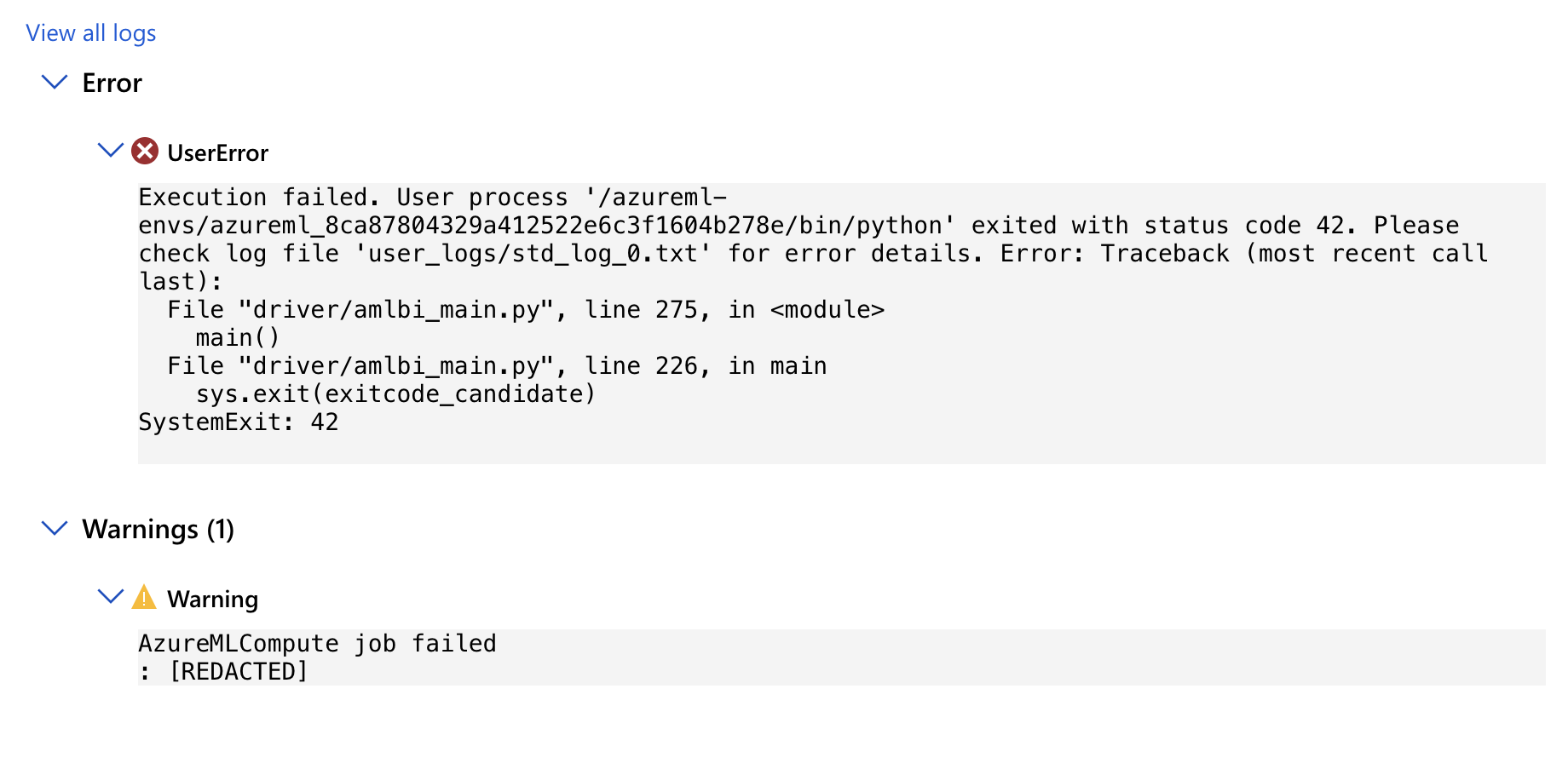

  3. Vinu Bhambore 0 Reputation points
    2025-08-20T15:27:21.35+00:00
    @MicrosoftSupport: Hello, posting this here because I cannot raise a support ticket anymore. It keeps pointing me to documentations and the docs dont have solution to this issue.
    This is still an active issue. I'm facing the same error on our batch endpoints during inference. Please see screenshot below. Infact I tested it on some old batch endpoint that worked fine until a few weeks ago, and are now failing.
    Also I cannot edit the scoring script to fix the issue, because it is an auto-generated scoring script as I deployed the endpoint using no-code UI based endpoint.
    Please let me know of there is a support email I can send further details to.Screenshot 2025-08-20 at 11.22.05 AM
