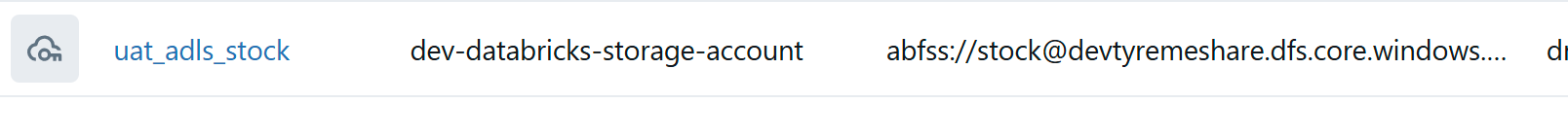

I've followed the book on Databricks for creating external location for Azure Data Lake Storage (ADLS V2) using account connector.

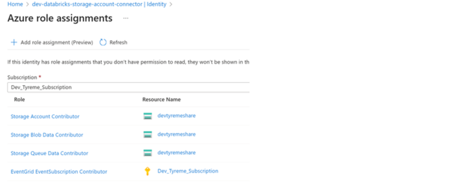

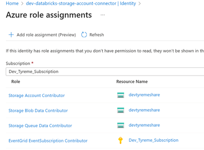

I've granted all required permissions to the connector:

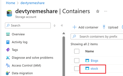

I've created a "stock" container on that above mentioned "devtyremeshare" storage account:
Configured storage account as recommended
Databricks can list and read files and folders:

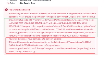

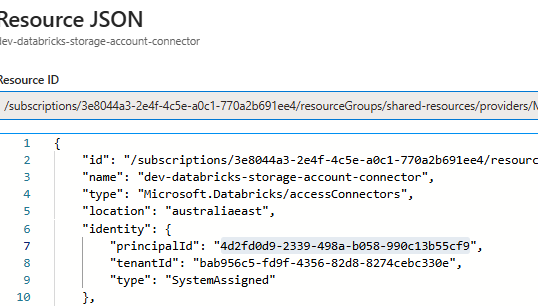

But fails to activate File Events. It reports missing permission to write into the storage account, even after I created an additional custom role with 'Microsoft.Storage/storageAccounts/write' permission on the subscription level and assigned to the app connector (which is 4d2fd0d9-2339-498a-b058-990c13b55cf9 below).
It feels to me that is not the IAM but something else.
Job, if hooking on file events, will error exactly the same.

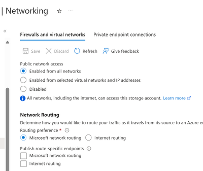

Storage account is public w/o firewall.
Databricks is default setup with public IP.

    Following your updates, I reached out to the internal team to take a closer look. After reviewing the setup with your configuration, the issue was successfully resolved by reconfiguring the connector setup from scratch.
    It appears that while all permissions (including Microsoft.Storage/storageAccounts/write and Microsoft.EventGrid/eventSubscriptions/write) were present, there might have been a transient inconsistency in how the identity or permissions were recognized by the backend during provisioning. A full teardown and recreation of the external location and connector resolved the conflict.

    • Reassigned roles explicitly at the storage account scope again (Storage Account Contributor, Storage Queue Data Contributor, and Storage Blob Data Contributor).
