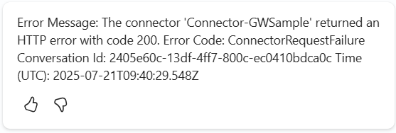

I'm encountering an issue while testing a custom connector in Copilot Studio. The connector is successfully tested in the Custom Connector Test tab, and it returns a valid HTTP 200 response with the expected OData payload. However, when I use this connector as a tool in a Copilot agent topic, I receive the following error:

    This is a common issue with custom connectors in Copilot Studio. Even though your connector returns HTTP 200, there are several Copilot-specific requirements that could be causing the ConnectorRequestFailure. Here are the most likely causes and solutions:

    The fact that it works in the connector test but fails in the topic strongly suggests a schema/format issue rather than a connectivity problem.
