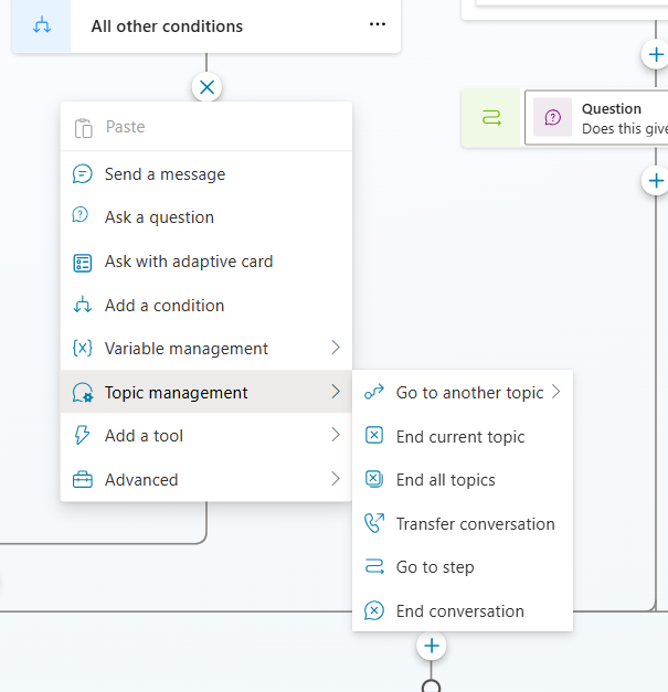

    This is a great question about multi-agent orchestration in Copilot Studio. Currently, there are some limitations with agent-to-agent handoffs, but here are the available approaches:
    Current Solutions
    1. Using "Transfer to Agent" Action (Recommended)
    In your Child Agent:
    Add a "Transfer to agent" action at the end of your topic
    Select your Parent Agent from the dropdown
    This creates a handoff back to the parent
    Configuration:
    Go to your child agent topic
    Add action: "Transfer to agent"
    Select: [Your Parent Agent Name]
    Add a message like: "Transferring you back to the main assistant"

    Recommended Implementation
    Step-by-step:
    In each Child Agent topic:
    End with: "Is there anything else I can help you with?"
    Add: "Transfer to agent" → Select Parent Agent
    In Parent Agent:
    Create a "Welcome Back" topic
    Trigger: After agent transfer
    Message: "I'm here to help with any other questions!"
    Test the flow:
    User asks question → Parent routes to Child
    Child answers → Transfers back to Parent
    Parent ready for next question
