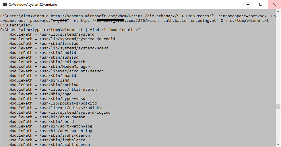

I've exported the pack and it seems that this wsman command is run by the workflow:
winrm e http://schemas.microsoft.com/wbem/wscim/1/cim-schema/2/SCX_UnixProcess?__cimnamespace=root/scx
I ran this manually on the gateway and it does give output, an xml of over 8000 lines. The managementpack contains a select statement for auditd, i'm not sure if this is done in the winrm command or after the feedback is received.
The error indicates to me that the command was ok but someting in the output (is that the callback?) is not correct.

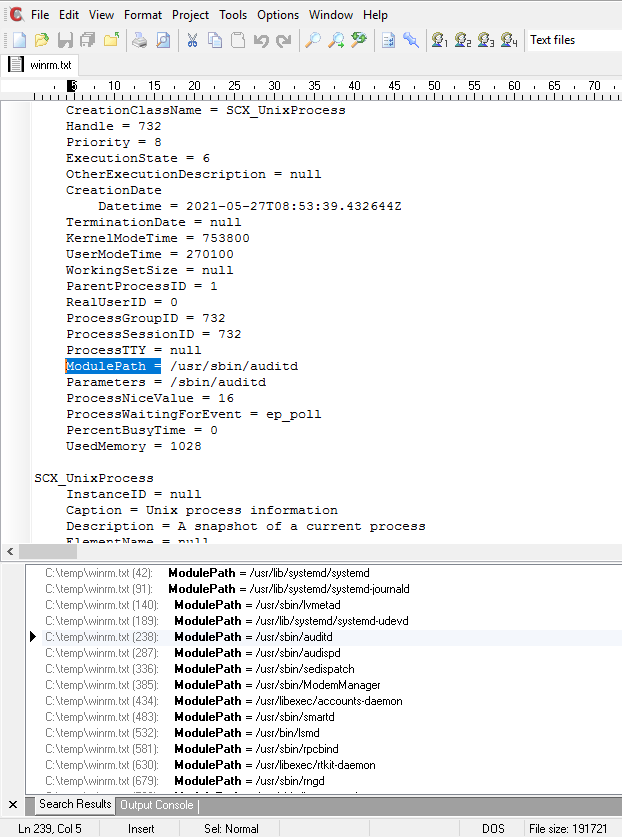

  3. Berg, Ronald van den 46 Reputation points
    2021-06-17T12:35:19.087+00:00
    Thanks both for your answers.
    The tracing script looks very good but did not give me anything useful. The script it'self doesnt work at all after you download it but after a minor adjustment it did. I've created the special override and used the specific method to trace, waited till the event was created but noting usefull in the logs.
    I also used the old way of tracing by creating the empty file EnableOpsMgrModuleLogging and also could not find anything useful.
    I also compared the output with an agent that does not give this error.
    The specific part of xml of the process auditd looks simular, only the paths differ but that should not be a problem i guess.
    bad server = <p:ModulePath>/usr/sbin/auditd</p:ModulePath>
    good server = <p:ModulePath>/sbin/auditd</p:ModulePath>
    I do note that the output of the good server contains about 25000 lines of xml, the failing server contains over 50000 lines, so maybe that is the issue.
