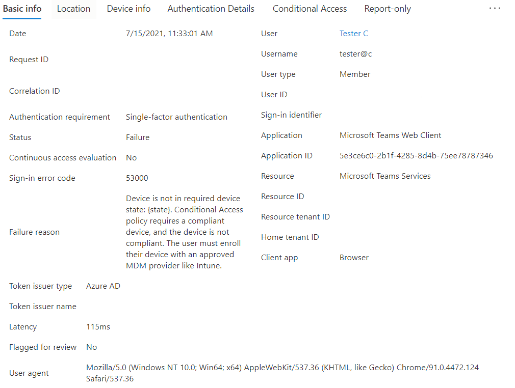

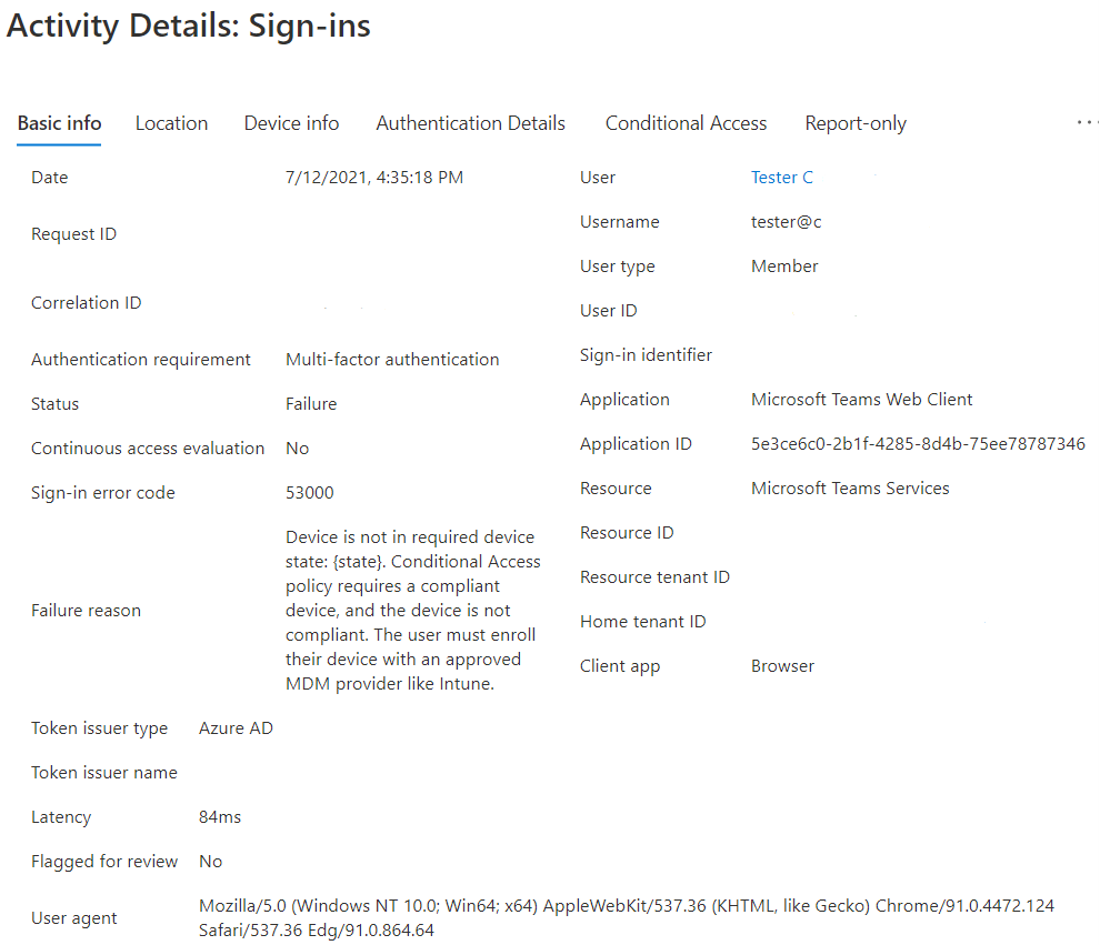

    Our issiue isn't Linux related at all, we cannot sign in to Teams from browser on any platform except for Edge on Hybrid Azure AD joined devices.
    I know that SSO won't work on other platforms but in our scenario we want to allow teams on non domain joined devices after in-browser sign in.
    After succesfull in browser sign in on teams.microsoft.com (Chrome on Windows 10 or any other supported brower on any platrorm on non domain joined device) user is greeted with the message below and only option is to sign out.
    In AAD Admin Center I get this failure reason:

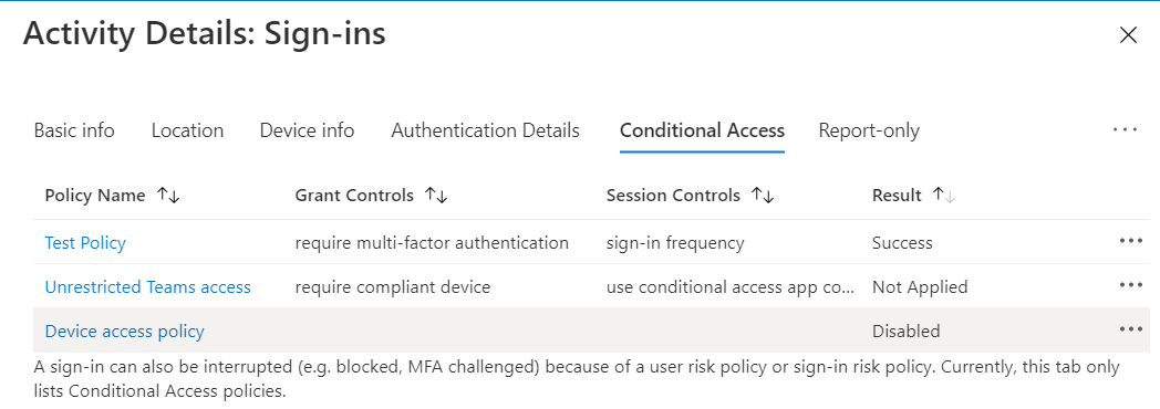

    But no conditional access policy applied to the test user requires a compliant device:
