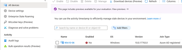

    As my experience, there may be the following reasons:
    • Your device disabled or deleted by your admin, as shown below:
    • Device has no line of sight to the Domain controller.
    The device must be on the organization’s internal network or on VPN with network line of sight to an on-premises Active Directory (AD) domain controller.
    • Your organization have their own local environment, cannot compatible with Azure AD(This will cause many people in your organization unable to log in desktop application)

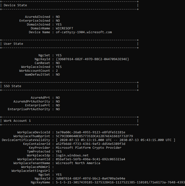

    So please contact with your IT admin to check this issue, and please try to run as administrator to executes this command dsregcmd /status and send me the screenshot of the complete result, as shown below:

    In addition, please Click Start button and input Command Prompt, run as administrator, then type
    dsregcmd /status
    please send me the screenshot of the result.
