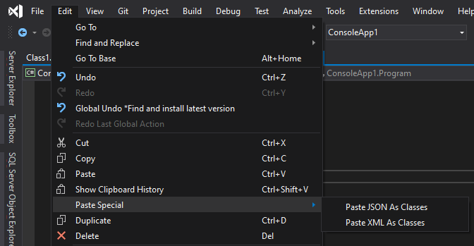

    Update(6/22):
    Copy the xml, and then use the functions of visual studio to construct a class that conforms to its structure.
    This feature requires you to install certain workloads, such as ASP.NET and web development. To prevent you from being unable to use this feature without installing these workloads, I will provide you with the produced class as an attachment.
                string strs = File.ReadAllText(@"C:\...\test-xml.xml");
                XmlSerializer serializer = new XmlSerializer(typeof(envelope));
                envelope result;
                using (TextReader reader = new StringReader(strs))
                     result = (envelope)serializer.Deserialize(reader);
                string JSONstring = JsonConvert.SerializeObject(result, new JsonSerializerSettings()
                    NullValueHandling = NullValueHandling.Ignore,
                var xml = JsonConvert.DeserializeXmlNode("{\"envelope\":" + JSONstring + "}", "envelope");
    108021-envelope.txt
