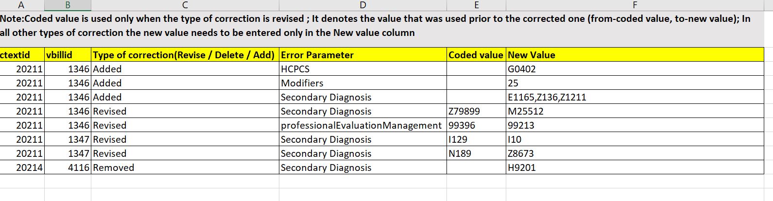

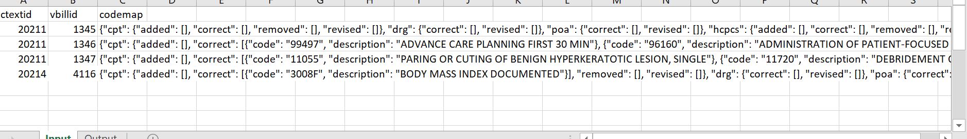

Hope you are doing well!...I am trying to split the different parameter values for just the correct ,added and removed codes at a vbillid level..In the attached excel file the column codemap has the json from which the codes (belonging to removed, revised or added need to be extracted) from the different coding parameter categories such as cpt drg, modifiers, secondaryDiagnosis, principalDiagnosis, secondaryProcedure, observationhours , dischargeStatus ,principalprocedure,hcpcs
Attached the excel file with the input and the output data sheets...Can you please help me here...

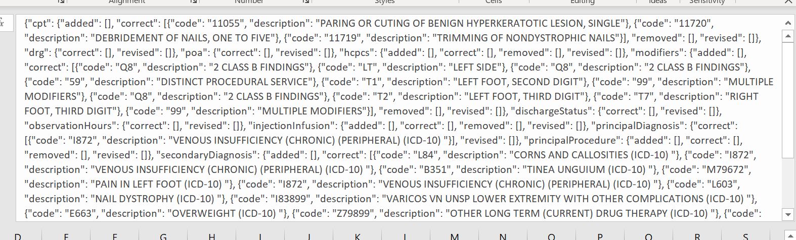

Below is how my JSON data looks like
{"cpt": {"added": [], "correct": [{"code": "99497", "description": "ADVANCE CARE PLANNING FIRST 30 MIN"}, {"code": "96160", "description": "ADMINISTRATION OF PATIENT-FOCUSED HEALTH RISK ASSESSMENT INSTRUMENT (EG, HEALTH HAZARD APPRAISAL) WITH SCORING AND DOCUMENTATION, PER STANDARDIZED INSTRUMENT"}], "removed": [], "revised": []}, "drg": {"correct": [], "revised": []}, "poa": {"correct": [], "revised": []}, "hcpcs": {"added": [{"code": "G0402", "description": "INITIAL PREVENTIVE EXAM"}], "correct": [], "removed": [], "revised": []}, "modifiers": {"added": [{"code": "25", "description": "Significant Separately Identifiable E&M Service by the Same Physician on the Same Day"}], "correct": [], "removed": [], "revised": []}, "dischargeStatus": {"correct": [], "revised": []}, "observationHours": {"correct": [], "revised": []}, "injectionInfusion": {"added": [], "correct": [], "removed": [], "revised": []}, "principalDiagnosis": {"correct": [{"code": "Z0000", "description": "ENCNTR FOR GENERAL ADULT MEDICAL EXAM W/O ABNORMAL FINDINGS (ICD-10) "}], "revised": []}, "principalProcedure": {"added": [], "correct": [], "removed": [], "revised": []}, "secondaryDiagnosis": {"added": [{"code": "E1165", "description": "TYPE 2 DIABETES MELLITUS WITH HYPERGLYCEMIA (ICD-10) "}, {"code": "Z136", "description": "ENCOUNTER FOR SCREENING FOR CARDIOVASCULAR DISORDERS (ICD-10) "}, {"code": "Z1211", "description": "ENCOUNTER FOR SCREENING FOR MALIGNANT NEOPLASM OF COLON (ICD-10) "}], "correct": [{"code": "M25512", "description": "PAIN IN LEFT SHOULDER (ICD-10) "}, {"code": "Z7984", "description": "LONG TERM (CURRENT) USE OF ORAL HYPOGLYCEMIC DRUGS (ICD-10) "}, {"code": "Z791", "description": "LONG TERM (CURRENT) USE OF NON-STEROIDAL NON-INFLAM (NSAID) (ICD-10) "}, {"code": "Z0000", "description": "ENCNTR FOR GENERAL ADULT MEDICAL EXAM W/O ABNORMAL FINDINGS (ICD-10) "}, {"code": "M25512", "description": "PAIN IN LEFT SHOULDER (ICD-10) "}, {"code": "Z7984", "description": "LONG TERM (CURRENT) USE OF ORAL HYPOGLYCEMIC DRUGS (ICD-10) "}, {"code": "Z791", "description": "LONG TERM (CURRENT) USE OF NON-STEROIDAL NON-INFLAM (NSAID) (ICD-10) "}, {"code": "Z1339", "description": "ENCNTR SCREEN EXAM FOR OTHER MENTAL HLTH AND BEHAVRL DISORD (ICD-10) "}], "removed": [], "revised": [{"to": {"code": "M25512", "description": "PAIN IN LEFT SHOULDER (ICD-10) "}, "from": {"code": "Z79899", "description": "OTHER LONG TERM (CURRENT) DRUG THERAPY (ICD-10) "}}]}, "secondaryProcedure": {"added": [], "correct": [], "removed": [], "revised": []}, "facilityEvaluationManagement": {"added": [], "correct": [], "removed": [], "revised": []}, "professionalEvaluationManagement": {"added": [], "correct": [], "removed": [], "revised": [{"to": {"code": "99213", "description": "OFF/OP VIS, EST PT, 2KEY COMP: EXPAND PROB HX; EXPAN"}, "from": {"code": "99396", "description": "PERI COMP PREV MED E&M W/HX/EXAM, EST PT;40-64YR"}}]}}
Also below the way my Input and output tables looks like
Can you please help me here!..
