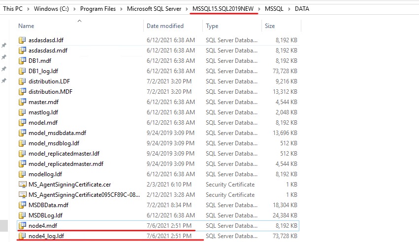

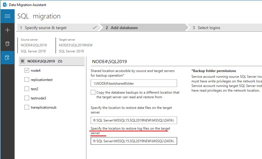

  5. CathyJi-MSFT 22,396 Reputation points Microsoft External Staff
    2021-07-06T07:08:21.01+00:00
    Hi @Pds ,
    > During backing up when DMA running FULL Backup to share folder not sure which cause to break the log chain as we are running hourly Transaction log backup (every hour) so i am just curios should I stop the Transaction Log backup job during that time or let DMA run the backup and restore and that will safe process which will not affect any log chain sequence.
    The DMA also has log back up. It does a data backup and log backup. It has the data files and log files as below screenshot. Suggest you stopping the transaction log backup job during that time.
