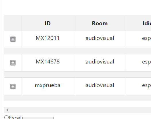

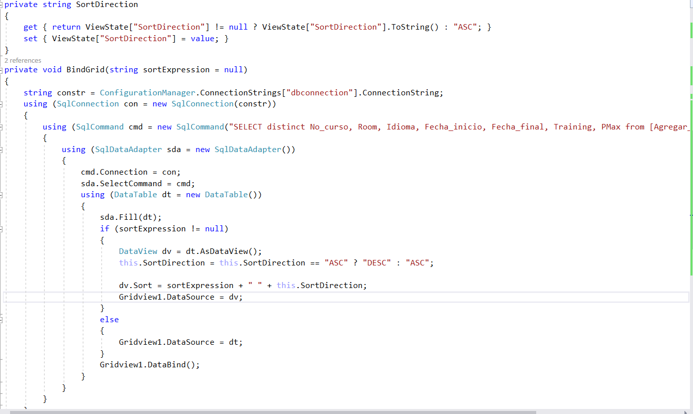

Hi, I try to use a function to sort and paging, but doesn't works, in in the "design mode" appear the paging, but when I run the program, doesn't appear nothing.
and when I run it:
C#:
private string SortDirection
            get { return ViewState["SortDirection"] != null ? ViewState["SortDirection"].ToString() : "ASC"; }
            set { ViewState["SortDirection"] = value; }
        private void BindGrid(string sortExpression = null)
            string constr = ConfigurationManager.ConnectionStrings["constr"].ConnectionString;
            using (SqlConnection con = new SqlConnection(constr))
                using (SqlCommand cmd = new SqlCommand("SELECT distinct No_curso, Room, Idioma, Fecha_inicio, Fecha_final, Training, PMax from [Agregar_sesion]"))
                    using (SqlDataAdapter sda = new SqlDataAdapter())
                        cmd.Connection = con;
                        sda.SelectCommand = cmd;
                        using (DataTable dt = new DataTable())
                            sda.Fill(dt);
                            if (sortExpression != null)
                                DataView dv = dt.AsDataView();
                                this.SortDirection = this.SortDirection == "ASC" ? "DESC" : "ASC";
                                dv.Sort = sortExpression + " " + this.SortDirection;
                                GridView1.DataSource = dv;
                            else
                                GridView1.DataSource = dt;
                            GridView1.DataBind();

        protected void OnSorting(object sender, GridViewSortEventArgs e)
            this.BindGrid(e.SortExpression);
        protected void OnPageIndexChanging(object sender, GridViewPageEventArgs e)
            GridView1.PageIndex = e.NewPageIndex;
            this.BindGrid();

  1. Yijing Sun-MSFT 7,106 Reputation points
    2021-07-08T03:41:17.81+00:00
    Hi @Anonymous ,
    In your codes,you don't specify what field to sort by. So it will sort by the first field on default. I have changed the sort of No_curso and it works fine with Sorting. You could check your data.
    2021-07-07T03:28:35.36+00:00
    Hi @Anonymous ,
    How many data in your datebase? I have run your codes and I have 11 records. It works fine.Your pagesize is 10. So,the records need more than 10 to show the paging.
    Or do you have other codes?
