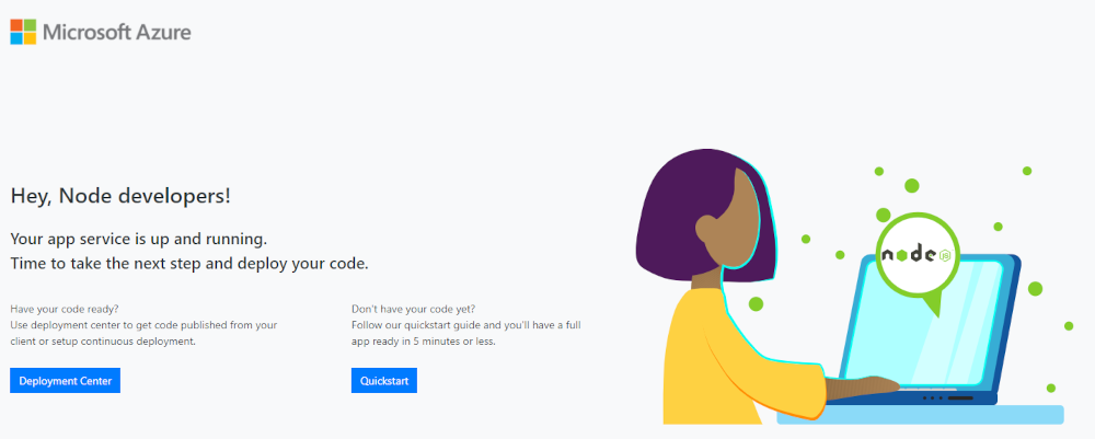

I also tried to follow this, it deploys, but if I browse the app I get:
And in the logs I find:
2021-07-07T08:26:19.215Z ERROR - Container XXXXXXX for site XXXXXXX did not start within expected time limit. Elapsed time = 230.9546994 sec 2021-07-07T08:26:19.233Z ERROR - Container XXXXXXX didn't respond to HTTP pings on port: 8080, failing site start. See container logs for debugging.

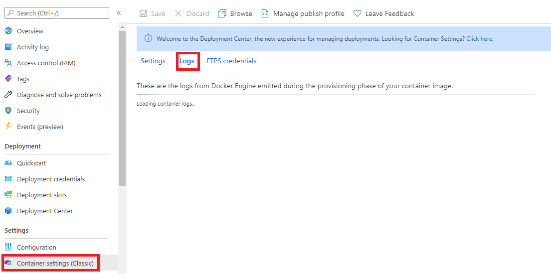

  1. Andriy Bilous 11,821 Reputation points MVP Volunteer Moderator
    2021-07-07T18:28:38.65+00:00
    You may troubleshoot WebApp and check logs here
    You can try this Dockerfile
