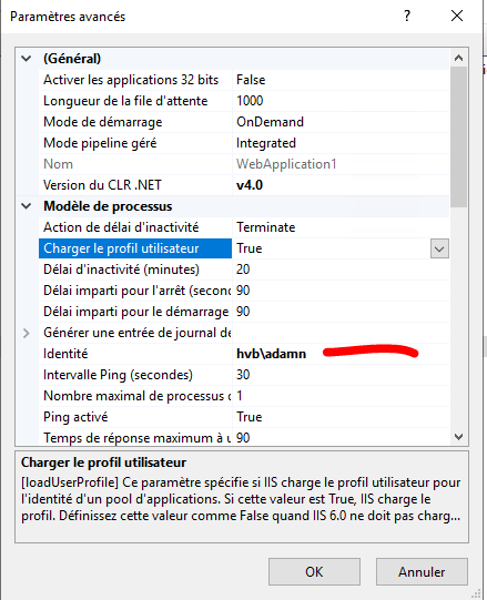

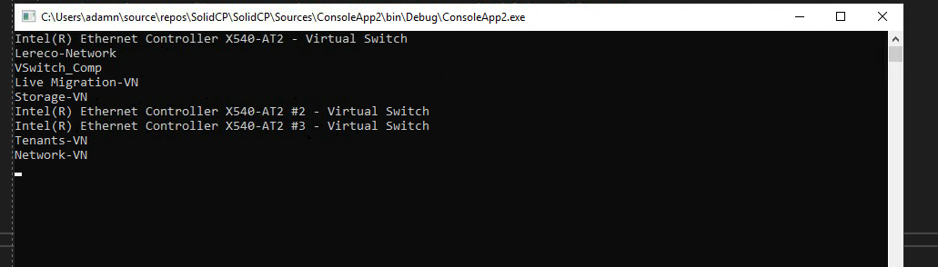

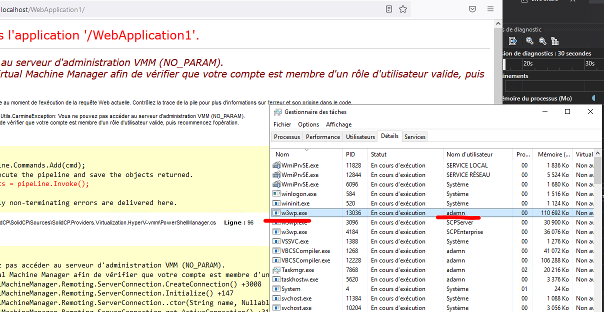

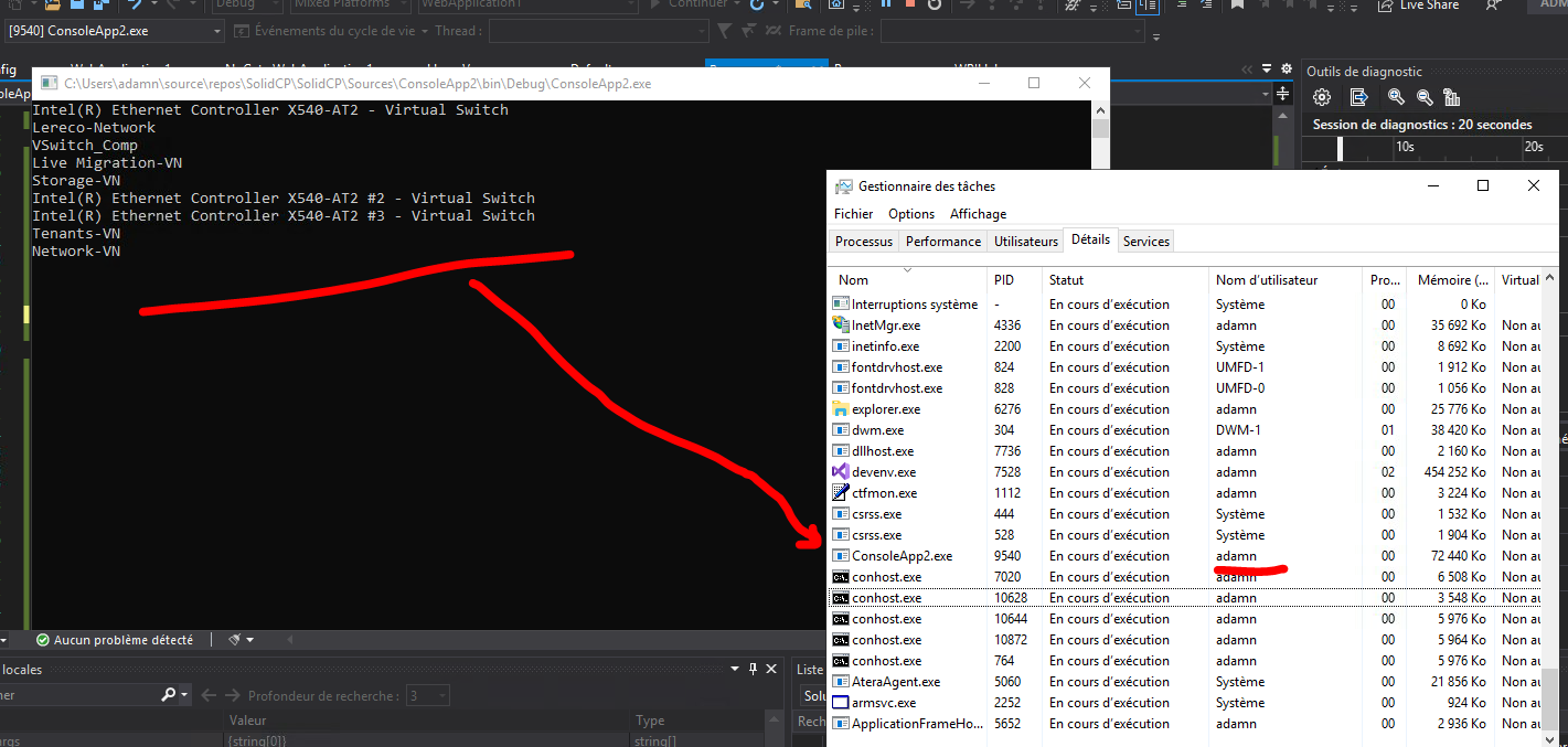

  4. Emmanuel Vaussion 1 Reputation point
    2021-07-13T07:07:49.873+00:00
    You must not apologize for not being able to answer me right now.
    On the other hand, I am not sure that you are understood correctly.
    IIS or IISEXPRESS is the same problem.
    Let's only talk about IIS.
    I did use an administrator account, the same as that of the console. Yet it does not work. See the screenshots.
