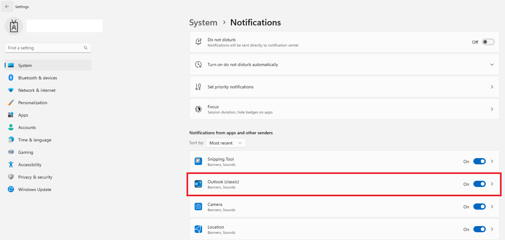

Since the end of last week (i.e. 12/13 June 2025) Outlook hasn't been giving me notifications for new emails (i.e. the notification alerts in the bottom-right corner of the scree). Also, the new-email icon doesn't appear on the Outlook logo in the taskbar. This means I can work all day thinking I'm not getting emails, then open my inbox and it's full of urgent work which I've missed.
The meeting alerts dialog box works okay.
I have all notification-related settings turned on (see image). "Do not disturb" is not turned on.
We have turned settings off and on again, re-installed outlook, and restarted the app and my computer, and nothing has fixed it.
Is there a way to fix this? It's quite annoying! I prefer to keep using classic Outlook instead of New Outlook.
I am using Windows 11 Enterprise.

    Hi Lily, thank you for your reply and apologies for the delay.
    Unfortunately, the first two steps didn't seem to work for me. And I am still not getting the notifications.
    My account is a work account, and so I can't try to create a new account (as our organization won't allow that).
    The notifications work with "New Outlook", so I believe it is a bug with my classic outlook. However, two coworkers are having the same issue.

    Can you kindly help to check whether you can find Outlook (classic) in System settings for Notifications in your computer?
    If yes, kindly help to share the notification settings for this app and also share which version of classic Outlook that you are using?
