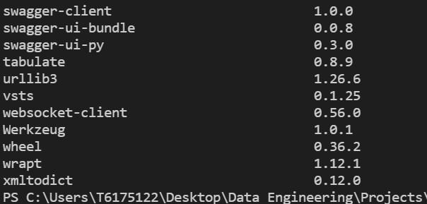

Hello Everyone ,
As soon as we add import swagger_client as cris_client to the init.py code and we deploy it function give 500 error . If comment that line out then it works. We do need to use swagger client library that we imported to do speech to text project.

Tigran 96 Reputation points
2021-07-13T18:11:57.61+00:00
Thanks. i was able to fix the issues by providing package path to swagger instead of providing name of the package in the requirments.txt. Thanks again

  1. MayankBargali-MSFT 71,016 Reputation points Moderator
    2021-07-13T06:42:04.96+00:00
    @Tigran Can you navigate to your application insights logs for your function app and verify what exception is logged for the 500 error. It looks like module not found.
    Can you confirm which module you are referring as swagger_client or cris_client as I don't see as pypi packages. If the modules can be installed using pip then you can mentioned the same in your requirements.txt
    But in case if those module or dependencies cannot be installed using pip then you need to use build native dependencies or enable remote build.
    You can refer to python troubleshooting document for more details.
