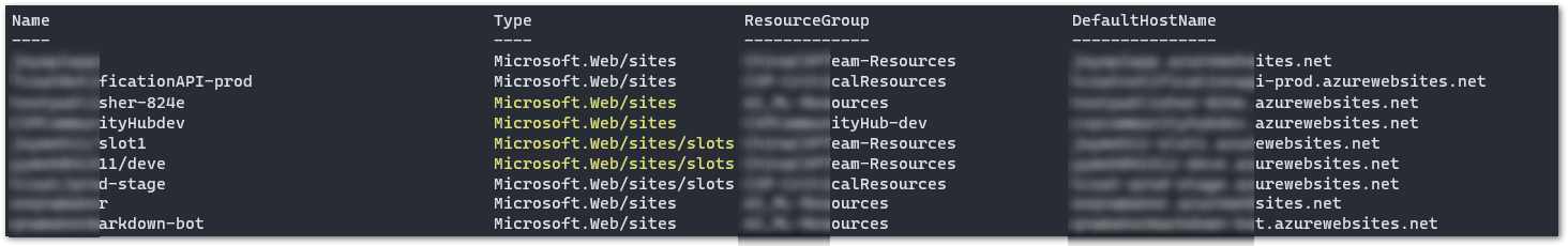

    @Mohan Dass You can use any of the following options that suits you best:
    Azure PowerShell:
       # Get Azure WebApps across all resource groups in your Subscription
       $siteNames = Get-AzWebApp
       # Get Azure WebApp Slots across all resource groups in your Subscription
       $slotNames = Get-AzWebApp | Get-AzWebAppSlot
       # Combine the result
       $result = $siteNames + $slotNames
       # Extract necessary properties from the result
       $result | Format-Table -Property Name, Type, ResourceGroup, DefaultHostName
    Sample Output:

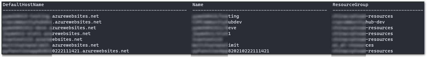

    Azure Resource Graph through Azure CLI:
    Alternatively, you can consider pulling this data from Azure Resource Graph, as it is engineered for fast responses!
    With the resource-graph extension for Azure CLI, you can craft a command to query this information as under:
       az graph query -q "resources | where type == 'microsoft.web/sites' or type == 'microsoft.web/sites/slots' | extend resourceProperties = parse_json(properties) | extend defaultHostName = tostring(resourceProperties.defaultHostName) | project name, resourceGroup, defaultHostName" --subscriptions 00000000-0000-0000-0000-000000000000 -o table
    and work through the result as needed. Another great advantage that comes with using Azure Resource Graph in this way is the ability to query across subscriptions. Use the --subscriptions parameter to pass in a space-separated list of Subscription IDs to scope your results appropriately.
    Sample Output:
