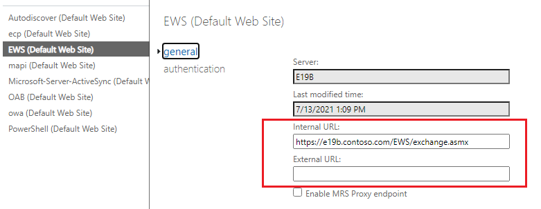

    If it is the case, I suppose that the possible cause of the problem would be the EWS(Exchange Web Services) virtual directory, which is responsible for free/busy.
    Please run a Test E-mail Autoconfiguration via Outlook client with the credentials of the test user on the affected server.
    Check the results under the "Results" tag to see if the URL of Availability Service is returned correctly:
    And check if it matches the internal or external URL settings of the EWS virtual directory on the affected server in EAC.
