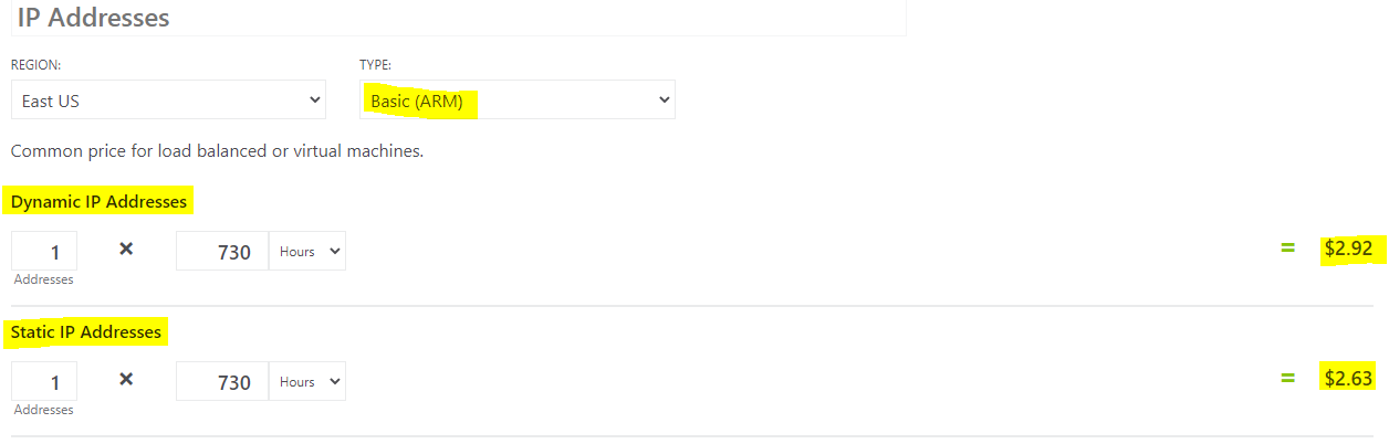

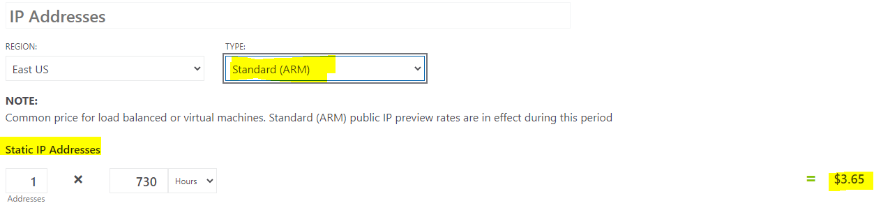

      Conversely, If it is a separate cost, configuring with dynamic IP instead, is this cost waived? : Like I mentioned before, Public IP addresses have a nominal charge as below:
      Basic (ARM) dynamic Public IP address costs $0.004/hour
      Basic (ARM) Static Public IP address costs $0.0036/hour
      Standard (ARM) Static Public IP address costs $0.005/hour
    So, if you check the monthly pricing of these Public IP addresses, their difference is not a lot:
