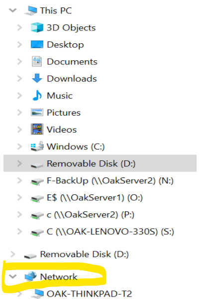

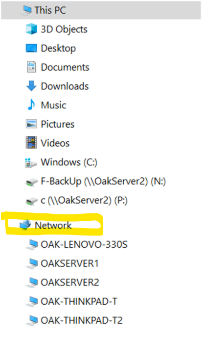

PC 1 : accesses all networked PC's correctly - see image below : OAK-THINKPAD-T
PC2 : only accesses the local networked PC - see image below : OAK-THINKPAD-T2
The only major difference between the 2 PC's is that PC2 - OAK-THINKPAD-T2 has MS Teams running and this could be causing an issue. We are unable to access & open Mapped network drives even though they display.

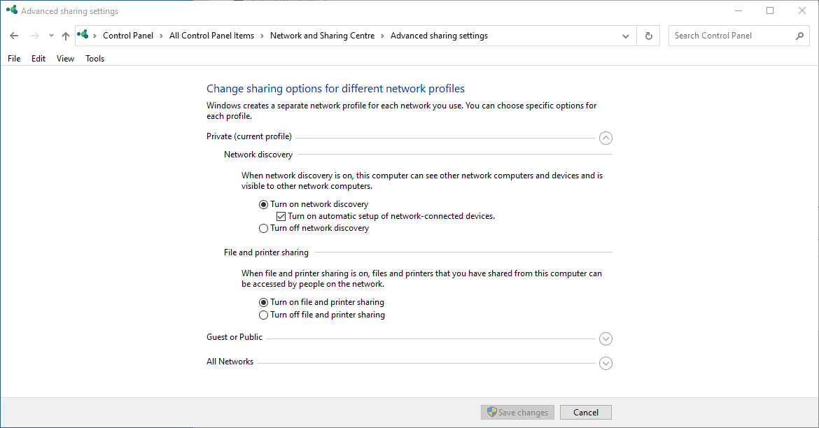

    The first thing that I would check/compare is the "Advanced sharing settings" on each PC. The choice of profile is often set when the PC first connects to the network, so could easily differ between the two devices.
    Gary
  2. Murray Croft 96 Reputation points
    2021-07-13T13:01:52.393+00:00
    Thanks Gary.
    Can confirm both are identical.

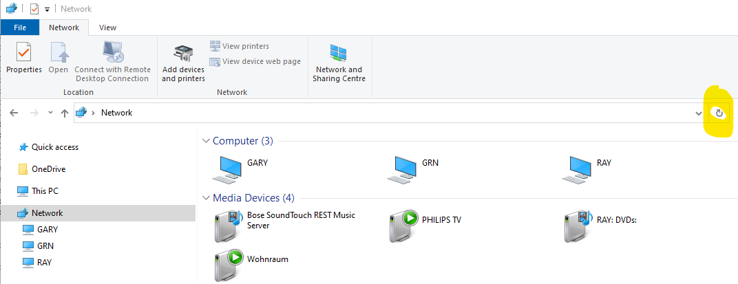

    For the missing PC problem, click on the "refresh" symbol in File Explorer (for the Network item) while the trace is running:
