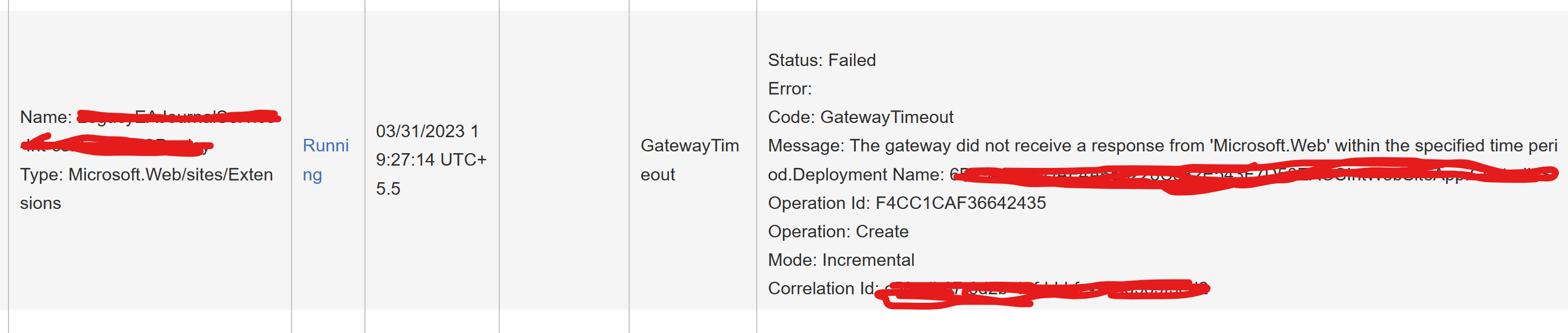

I'm deploying an app on a linux container in App Service, and I keep getting "Error: The gateway did not receive a response from 'Microsoft.Web' within the specified time period. (CODE: 504)" when updating settings (even with the Azure App Service Settings task).
I also get an error via the portal when I try to manually update the settings, it saves but I get an error (with no detail however).
