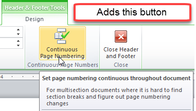

    As for vba solutions, there are the macros posted here; I have an Add-In on my site that allows a user to reset page numbering to continuous throughout (like the posted macro) at the push of a button. Continuous Page Numbering Add-In

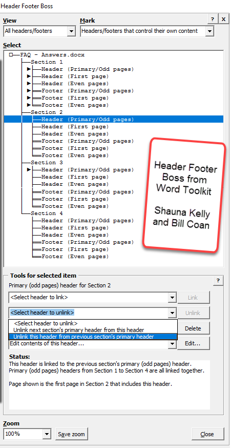

    In addition, Shauna Kelly worked out some code which has been molded into a vba Add-In by several of the volunteer MVPs here. It is on Lene Fredborg's site as Word Toolkit for Advanced Management of Word Headers and Footers. It makes it relatively easy to examine each section in a document. It shows sections which display no headers or footers because they are in the middle of a page.
