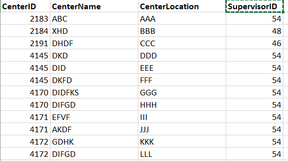

Hello Everyong,
i have below datatable and below models. i need to fill each CenterList with respectives CenterInfo list usig c# linq. can someone pls help me how to do this
public class CenterList
        public List<CenterInfo> centers;
        public int CenterID { get; set; }
        public int SupervisorID { get; set; }
public class CenterInfo
        public string CenterName;
        public string CenterLocation;
Thanks,
Krish

    You can try the get the data from database by using entity framework core, then you can try the Linq as below:
    var result = listdetail.GroupBy(t => t.CenterID).Select(t => new CenterList()
                    CenterID = t.Key,
                    centers = listdetail.Where(x => x.CenterID == t.Key).Select(c => new CenterInfo() { CenterName = c.CenterName, CenterLocation = c.CenterLocation }).ToList(),
                    SupervisorID = listdetail.Where(x => x.CenterID == t.Key).Select(c=> c.SupervisorID).FirstOrDefault()
                }).ToList();
