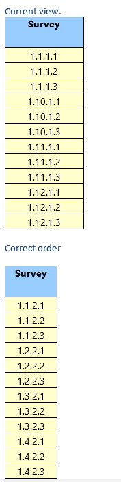

    This post is close to what I would like to do, but I don't understand the "answers" at all. My user has a spreadsheet and would like to sort the values a specific way:
    As you can see, the "ten" value in the middle number is not picked up as a "ten".
    Do you have any suggestions on how he can get his data sorted the way he wants?

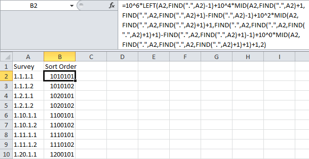

  3. HansV 462.4K Reputation points MVP Volunteer Moderator
    2014-03-14T21:00:40+00:00
    Recent versions of Excel should be able to do this the way he wants without requiring helper formulas.
    If that doesn't work, however:
    Let's say your data begin in A2.
    I'll assume that all entries are of the form a.b.c.d, and that a, b, c and d are either 1 or 2 digits (i.e. they are in the range 0 ... 99).
    In B2, enter the formula
    =10^6*LEFT(A2,FIND(".",A2)-1)+10^4*MID(A2,FIND(".",A2)+1,FIND(".",A2,FIND(".",A2)+1)-FIND(".",A2)-1)+10^2*MID(A2,FIND(".",A2,FIND(".",A2)+1)+1,FIND(".",A2,FIND(".",A2,FIND(".",A2)+1)+1)-FIND(".",A2,FIND(".",A2)+1)-1)+10^0*MID(A2,FIND(".",A2,FIND(".",A2,FIND(".",A2)+1)+1)+1,2)
    Fill down as far as the data in column A go.
    Then sort the range in columns A and B on column B.
