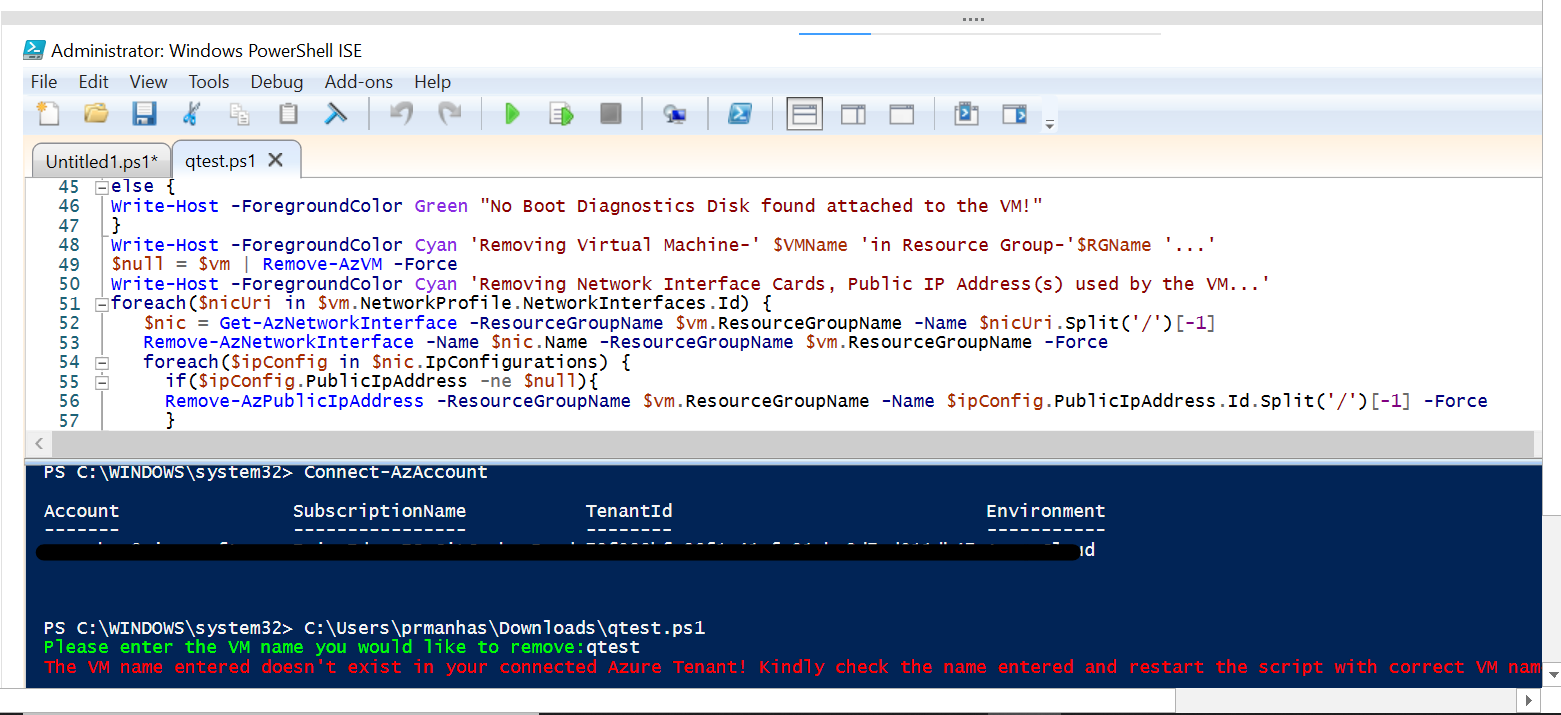

    First I tried the mentioned script which you were referring to and I can confirm I am getting the same error as per the Error handling outlined in the code:

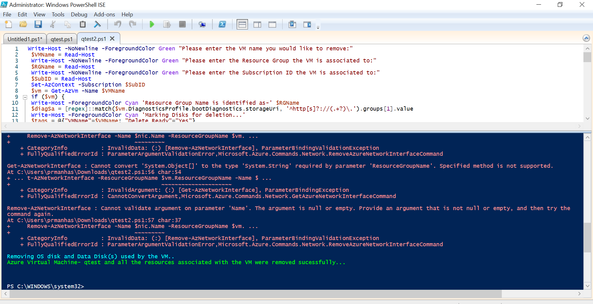

    Then I tried running your script as it is and it was executed successfully without any error:
    As per the error mentioned by you in the query it seems that there is a possibility that the associated disk with Azure VM was not found under the Subscription. Now there can be a lot of reasons for same but one among them what I can think of is maybe the disk was deleted from portal itself beforehand maybe accidentally by someone. When you delete a resource, there may be a short amount of time when the resource still appears in the portal but isn't actually available and that is why you are hitting the error because script was not able to find that resource. Another general perception about this error is that the Subscription you selected is the Subscription in which you actually have the resource since one single tenant might have number of subscription and sometime there might be confusion on same. Now assuming from your verbatim it seems like you have already checked it but will request you to check once more.
