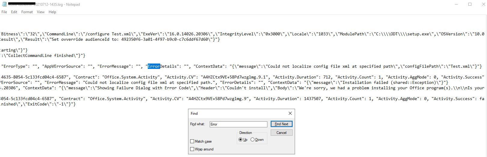

    Thank you, it appears you caught my frustrated typing error. "/configure" not "/configuration" ~ That said, I'm still broken. I'm getting:
    "We found a problem!
    We're sorry, we can't continue because we weren't able to download a required file. Please make sure you're connect to the internet or connect to a different network, then try again"
    I've tried 3 available networks and the internet is working on all three of these options, still not files installed or downloaded via /download
