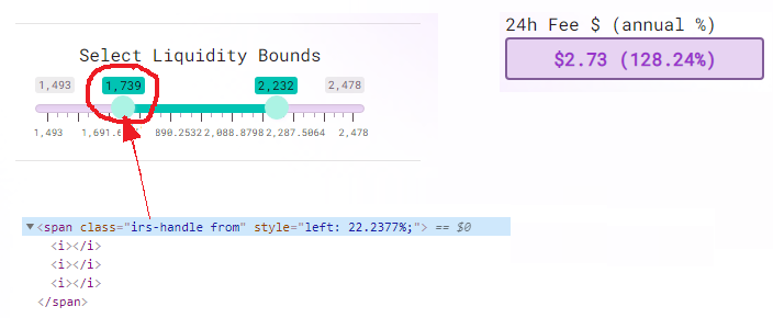

Hello,
I have tried for a while to manipulate a slider control in a CefSharp browser. I have succeeded using actual MouseButton/MoveCursor/SendMouseMoveEvent etc events.
However, I had some problems using those as it will not be accurate (due to the physical movements with the mousecursor where the 2 green circles with overlap eachother) and now I am struggling to move the below slider purely programatically instead. By manipulating the javascript. (It is the round green control where red arrow is pointing to)
I am using "Inspect Element" in the usual Chrome Browser control to get a clue of what I need to do.
When manually moving this slidercontrol with the mouse, one will see that a value is changed in the purple textbox(24h Fee $ (annual %)).
That value must change to get the complete functionality that I am trying to do.
I have succeeded to move this slidercontrol to the left with the below code (style.left = '5.1%'). But the slider is only moving to the left but the purple textbox(24h Fee $ (annual %)) is not changing any value which is my whole problem.
var response = await browser.EvaluateScriptAsync(@"(function () { document.getElementsByClassName('" + "irs-handle from" + "')[0].style.left = '5.1%';  })();");
Is it possible to figure out what is needed to be done more purely programatically in order to trigger so the value is changing in the purple textbox when the slider is moving to the left with below code?
Thank you!

  1. Timon Yang-MSFT 9,606 Reputation points
    2021-07-19T07:01:28.207+00:00
    This js code seems to only modify the css style of this slider and will not trigger any events.
    I think that although the method you used in the previous thread encountered an error, it was in the right direction, so I made some modifications based on this.
    The X value is correct, so we only need to get the correct Y value.
