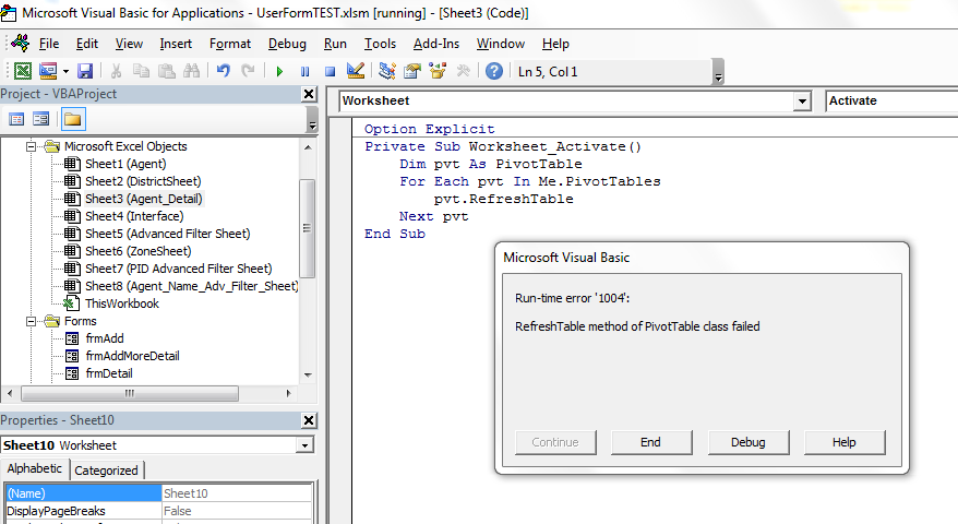

    2014-01-18T08:27:56+00:00
    Hi Hans,
    I don't know why this method works for one but not for another. I get the following error when I'm changing something:
    'Run Time Error: 1004: RefreshTable method of PivotTable Class failed'
    Though I have used exactly the same code you suggested, it still does not work. Can you please help me on this? I'm working on Excel 2013.
    ~Regards,
    Maneesh
