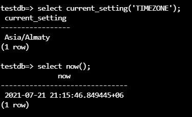

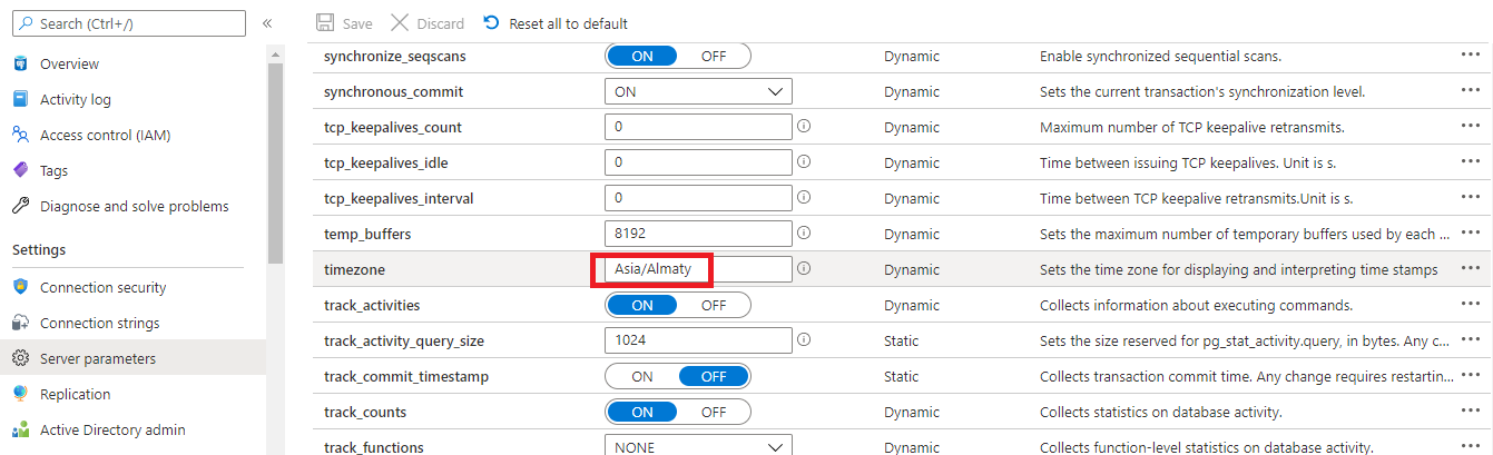

    Thanks for using Microsoft Q&A !! I am getting the correct results on PostGreSQL server with SELECT Now();. What's the time/timezone you are expecting. Can you please provide a screenshot ?
    Also, you can check your current PostgreSQL server timezone setting using the below query:
    If your timezone is not correct then you can use SET TIME ZONE to change it for specific region using the timezone abbreviation. Reference - SET TimeZone
