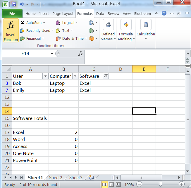

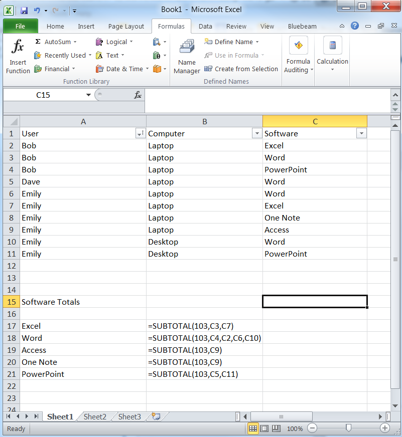

Here is my dataset not showing formulas:
Here is the formula view:
Lets say I filter the software column to just show Excel, here are my results:
These are the results that I want. (I don't want to count the hidden cells)

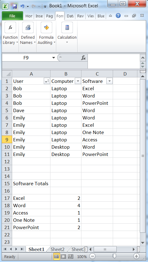

But then lets say I sort the name column so the names now appear in alphabetical order.

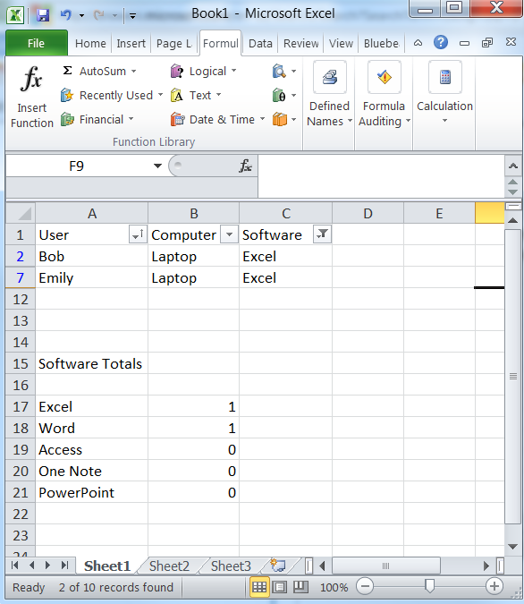

This will change the order of my rows and usually formulas will change as well, but the cell names I put into the SUBTOTAL formula do not change I my Software totals become wrong when I use filter (see last screenshot):
As you can see, the totals now show 1 Excel and 1 Word which we know is wrong.
Is there anyway the SUBTOTAL formula can be used with a string of text so "Excel" will always be counted instead of the actual cell.

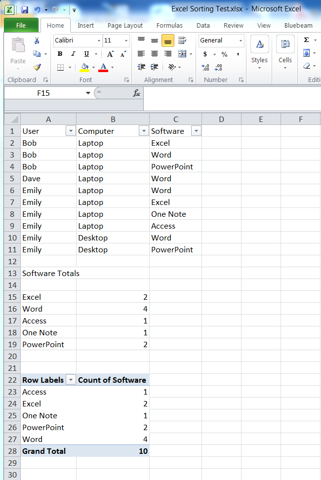

    You may simply create a Pivot Table- drag the Software column to the row labels and to the Value area section.
    Hope this helps.
    2013-08-22T19:55:26+00:00
    Hello Ashish,
    Thanks for the reply,
    I have been busy at work and finally got around to trying the Pivot Table Method, but it does not work.
    So I created the Pivot Table as you instructed (shown below):
    But When I use the filters, the "Count of Software" Column does not update. see below:

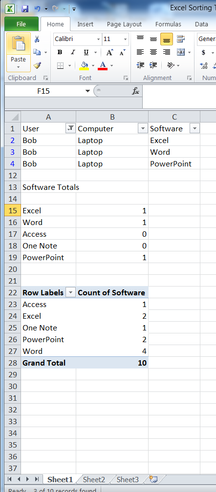

    Ex: lets say I just want to see Bob's software count, so I fiter the "User" Column to "Bob":
    As you can see the Pivot Table shows all the software and not just Bob's
    I need the counting to work with Filtering (by not counting hidden rows) AND Sorting (so when I sort it doesnt mess up my formulas, as I explained in my first post)
    Any help would be greatly apprieciated as this would make my record keeping and report making easier
  3. Ashish Mathur 101K Reputation points Volunteer Moderator
    2013-08-23T00:12:46+00:00
    Drag the User column to the Report filter area of the Pivot Table and in the Report filter drop down (not base data), select Bob.
    Hope this helps.
