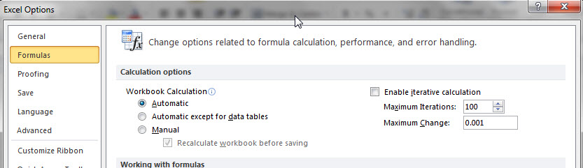

  5. Anonymous
    2014-06-21T22:07:33+00:00
    Go to the [File] tab, click the {Formulas} option.
    In the window that appears, in the first section, "Calculation options", make sure that Automatic is chosen.  Click [OK] and close the dialog.
