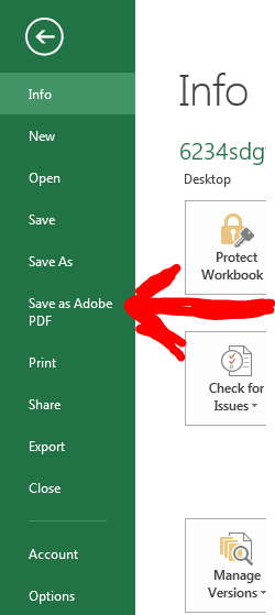

SOLVED:
Sometimes the solution can extremely simple when you are looking for something complex. I swear this hasn't always been here but apparently there is a "Save As Adobe PDF" selection now. When I used that and selected the entire workbook the links were functional.
After research I figured out that you need to fully update Acrobat XI before the Addin works with office 13.
