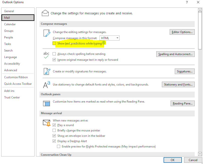

  5. Selena 0 Reputation points
    2023-02-21T21:40:35.8466667+00:00
    To disable it, in the Outlook desktop app, go to File--Options--Mail--Under Compose messages, uncheck "show text predictions while typing"
    predictive
