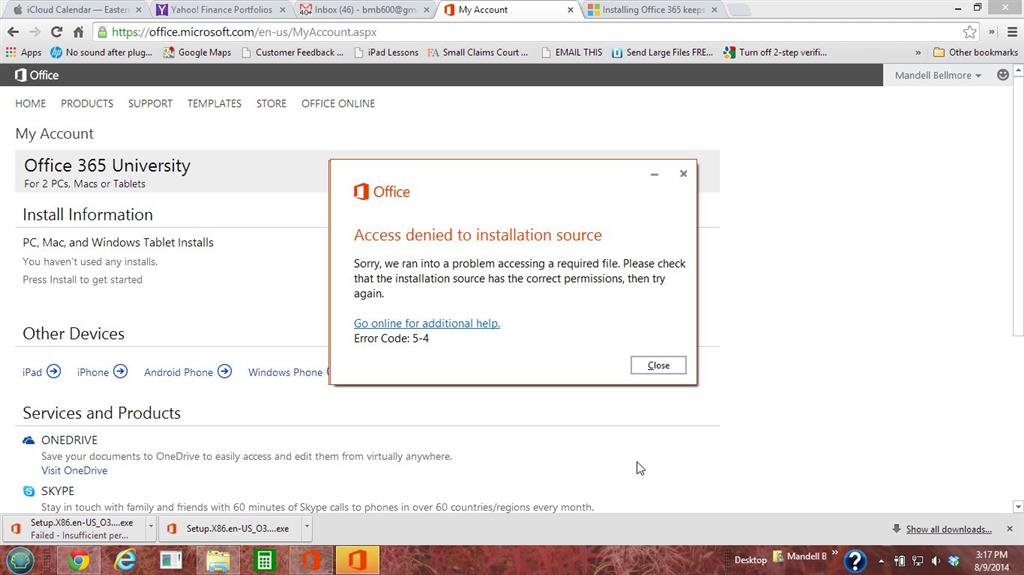

    2014-08-09T19:42:55+00:00
    I am using Office 365 University.  It was working fine until one day I opened Outlook and it would not open.  I attempted to uninstall Office 365 University.  The instructions that came with Office 365 University told me to go to www.office.com/verify, enter my 25 digit Product Key.  I went there and deactivated the product and then tried to re-install the product.
    I got Error Code 30175-11.  I looked up the Error Code and was directed to support.microsoft.com/kb/2739501 where I found a much more complete method of uninstalling Office 365 University.  My installation is a "Click-to-Run Installation.  I first used the 0125CTRRemove.diagcab to remove Office 365 University.  I followed up by using the information in KB 2739501, Click-to-Run instructions to find a few items that 0125CTRRemove.diagcab failed to get.
    I went back on line at www.office.com/verify, entered my 25 digit Product Code, and tried to install Office 365 University.  This time I got Error Code 5-4.  When I went on line with that Error Code, I found your help section.  Please help.  One of my choices is to uninstall Office 365 University and install Office Professional 2010.  When I get a new computer, I could then install Office 365 University.  My email address has not changed.
