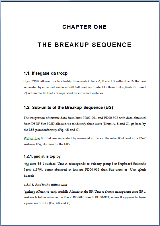

    2014-06-01T22:20:26+00:00
    Dear Guru Suzanne :)
    Thanks a lot! It worked very nicely. the only thing I couldn't do was to change the TOC, but since that will be an issue to fight with after the writing is done, I dont need to be so concerned for now...
    Nevertheless, I would like to ask something else, on the Header, using StyleRef fields I have now the chapter title on the right (with my new Chapter Title style) and I wantto have on the left "Chapter one", but it is not working. Of course is because I have nothing there, just the number... Can you please help me with this one too? Thanks!
    Below my new beautiful styles, now from Word itself! (the chapter number and title will be on a separate page):
