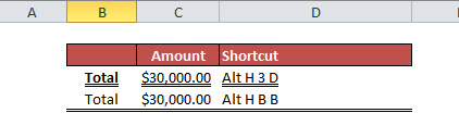

Since we have started using Excel 2010 and 2013 we have experienced a problem with some of our spreadsheets.  We are an Accounting department and have some intense spreadsheets.  When we are ready to print these and go to the print preview all of our underlines and double underlines appear, but when we print the page they don't print.  This doesn't happen to all of our spreadsheets, in fact, within the same workbook some spreadsheets print just fine and others are missing the underlines.  Nothing else seems to be missing.  I have recently, discovered that it seems to be related to the page setup.  If we change the scaling on the pages we are having trouble with to 99%, then the underlines print.  Unfortunately, this doesn't really help, because we need to be able to get all the information on one page.  Is there some kind of a fix for this.

    You can Use the Under Line Border Instead of Simple Under Line.
