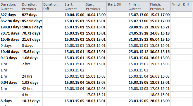

Hi
When running the Compare Projects in MS Project 2010.
The report is always blank in the "Diff" field.
So if I change duration on  a task it give me a column for old and current duration but the "Duration Diff" column stays blank.

    2014-08-26T21:10:06+00:00
    The Duration Dff field is actually Text6 - do you have Text6 in use somewhere else in the files?  The Start Diff and Finish Diff fields are also blank in your screen shot above.  They are Text9 and Text 12 - again, are these fields used for something else in the template?  Any error messages when you run the consolidation?
    2014-08-26T10:35:30+00:00
    Hi
    Its yes to all your questions above. The report give me current and previous data but not doing anything in the "Diff" columns. See screenshot:
