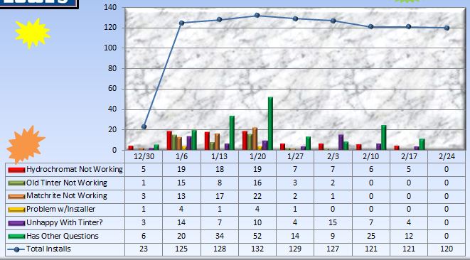

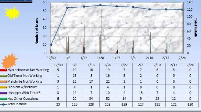

I have a bar chart that I created that has 7 series, ordered by date. I wanted to add a second vertical axis for the Total Installs line element.  The first pic is the original chart, the second pic is what happened to the bars after I added the 2nd axis. Does anyone know why this happens and how to change the width of the bars in the chart?

Excel is getting confused by the dates.  Not sure why.
You can fix it by double-clicking on the x-axis then selecting Axis Type: Text Axis.
Hope that helps.
Cheers
Rich

    Thank you sir. That actually worked like a champ.
