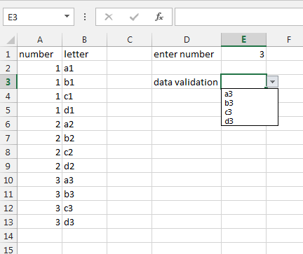

    2013-08-30T08:42:48+00:00
    Hello,
    dynamic range names are a valid source for data validation in Excel 2013. Please see the screenshot below. The data validation has been set to "List" which points to the range name "ListData". The formula for that range name is
    =INDEX(Sheet1!$B:$B,MATCH(Sheet1!$E$1,Sheet1!$A:$A,0)):INDEX(Sheet1!$B:$B,MATCH(Sheet1!$E$1,Sheet1!$A:$A,1))
    When the number in E1 is changed, the data validation drop down will show a different list.
    If this does not work for you, chances are that there is an error in the range name formula.

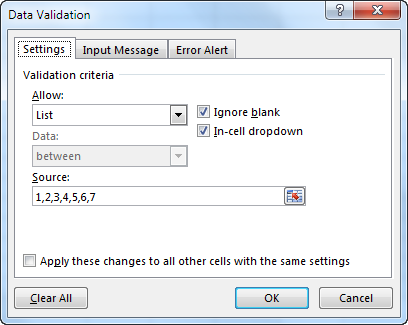

    To define a list right inside the data validation dialog, you do not need to enter the curly braces. Just enter the list items, separated by your regional list separator, which seems to be a semicolon. In my case it is a comma and the dialog looks like this:
    If you need help troubleshooting your range name formula, please post a sample file with some dummy data and the range name formula.
