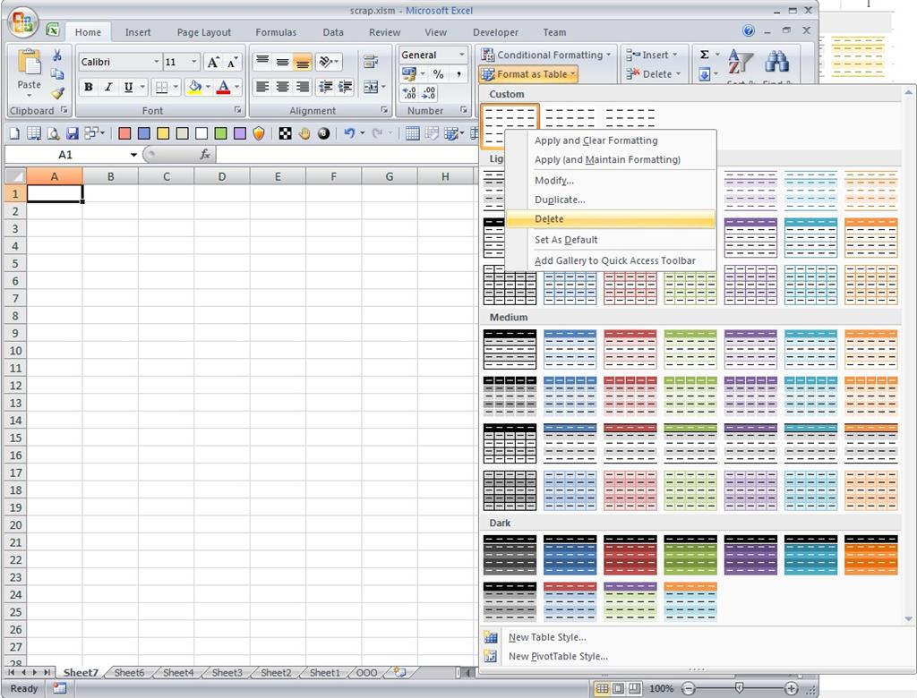

i have created a custom table style (Home, Styles, Format as Table, Custom).
right clicking and chosing "delete" gives a confirmation box but then does nothing.
nor does using VBA and TableStyles("myStyle").Delete.
i've checked that no tables in the workbook are using the style.
what am i doing wrong?

2014-09-29T14:14:17+00:00
found it.
undocumented rule.
"you can't delete a TableStyle from a workbook if one of its sheets is protected, even if that sheet does not reference that TableStyle."
annoying.
i hope someone finds this useful.
e.

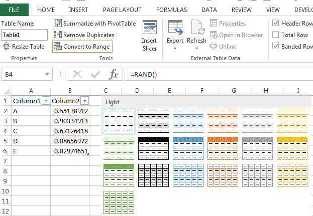

    2014-09-24T09:48:40+00:00
    Deleting the table does not remove the default formatting from the Range. Hence first select a None formatting for your table as selected in the below diagramand then click 'Convert to Range' in Table Tools Design Tab.
