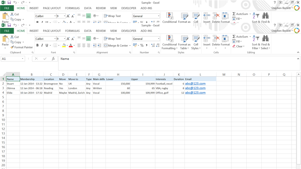

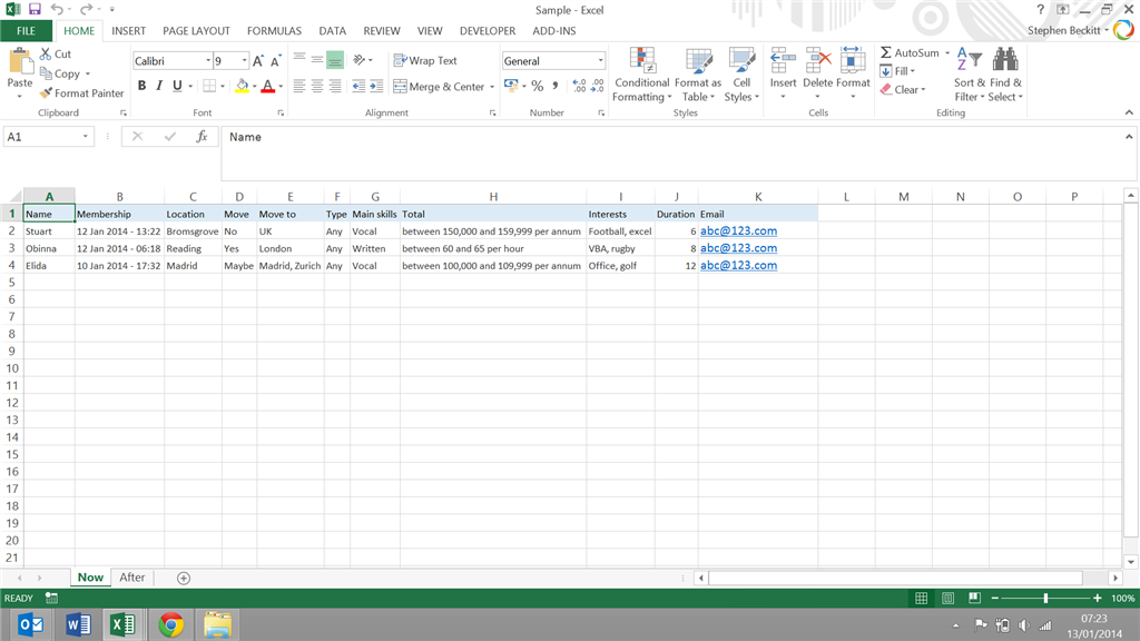

I need to remove all text from numbers within a cell, then split the two numbers across two cells and be formatted as numbers, not text. The cell contains text/numbers in the following formats:
between 150,000 and 159,999 per annum
between 60 and 65 per hour
between 70.00 and 74.00 per hour
There may be 1000s of other lines of these and they will always start in H2. There are occupied cells either side.
If possible the code needs to form part of a bigger macro that has actions before and after so it would be great to be able to copy and paste it into the middle.
I've attached a sample of how it looks and how I'd like it to look - there are two tabs for clarity but I'd like the solution to remain on the same tab.
Thanks in advance for your help.
