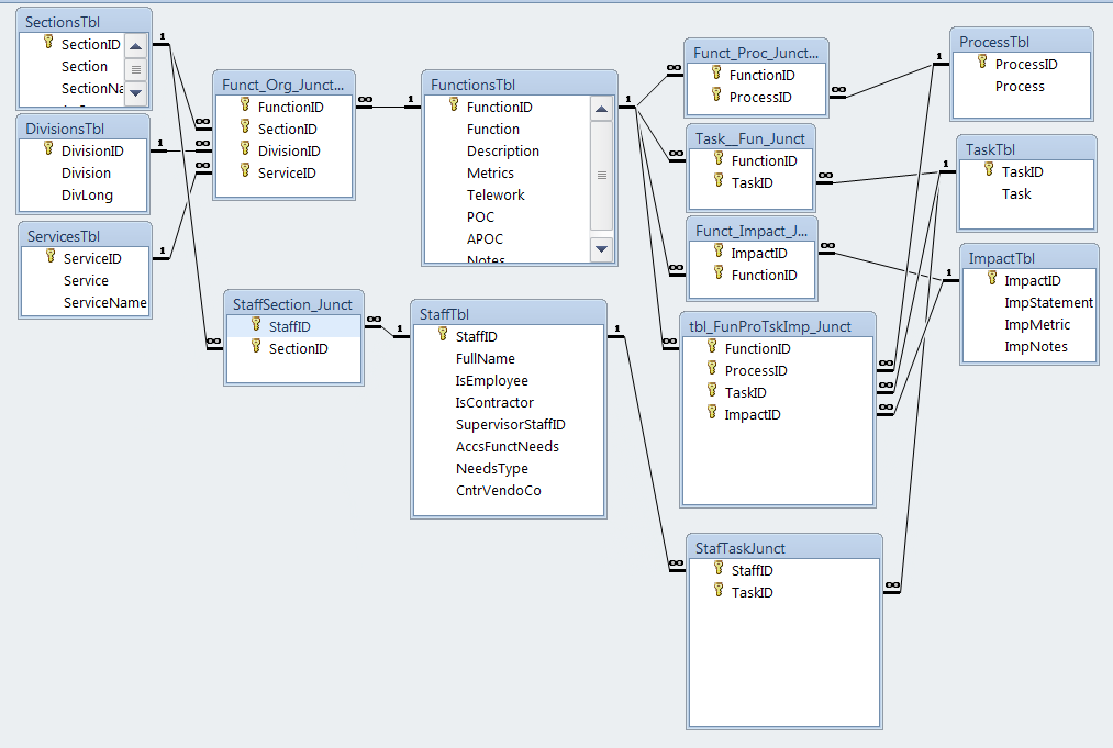

  • the record set consists of a Parent table for each unique type of data, and a 'Join Table' that defines by Parent table IDs the possible "combinations" for an established heirarchy based on records entered. Below is the Query view where I was attempting to set the cboDivision Row Source, based on a relationship from a junction table.

    Scott,
    This may help illustrate what part of the big picture is. Because my colleague and I find ourselves needing to accelerate from beginner knowledge of access to advanced, we may be doing things out of the ordinary or unorthodox, and I’m certain previous iterations of this DB had nothing but garbage.
    The whole junction table thing may be semantics, so let’s call them stand alone “join tables” of the PKs from several parent tables, the primary difference being that instead of several FK fields in the parent table, we put them in a table unto themselves. All the relationships are valid, information integrity (i.e. this record relates to that one) and DB functionality all work fine. If it matters, which I don’t think it does for the question- We will have other tables that are many-to-many (Apps, Programs, Files, Equipment that are needed to perform a ‘Function’) they just aren't moved in yet.  Regardless;

  2. ScottGem 68,830 Reputation points Volunteer Moderator
    2014-08-15T17:07:23+00:00
    Again, it is not clear that you need junction tables. Junction tables only exist to model a many to many relationship and I'm not see where you have those. You need to provide a better understanding of your structure, what is the real world situation you are modeling.

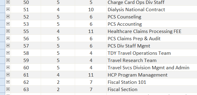

    2014-08-15T16:17:28+00:00
    Scott, I used FKs previously and it worked (see second pic above) but only for the Organization portion of the data. The foreign key method failed in later parts of the form I was trying to create. Once you get past the Organization elements, table relationships for all the other Parent tables get complex. Queries and such became really problematic when I tried using multiple foreign keys in each Parent table. I went with the junction option because it was very efficient for tying in different tables and data to others.
    In some instances the form versions failed because one or more record matches didn't yet have data in a particular field or fields. So far I don't have that problem using multiple junction tables. The query shows the current values for fields that have data, and leaves blank the ones that don't.  The reasons why the other foreign key design wasn't working properly regarding Null/Blank or no records fields isn't what I'm trying to solve here, but I included that as background for why I'm trying this method. So... back to matter of my question:

  5. ScottGem 68,830 Reputation points Volunteer Moderator
    2014-08-15T15:22:34+00:00
    I'm a little confused here. A junction table is used to model a many to many relationship. I'm not sure I am seeing that. Also, when you have a hierarchical structure you may not need to match each level. I haven't seen your other posts but some observations here.
    I see Service, Division and Section as Attributes of an Organization. The question is can a Division apply to multiple Services and a Service to multiple Divisions? Similar question on Division and Sections. If the answer to either is no, then you don't have a many to many and no need of Junction tables. If you do, then you do need the junction tables and your combobox Rowsources have to join the three tables together.
    If you don't have many to many then the next question is whether the hierarchy is exclusive. For example is there one division for each section so if you know the section do you know the division? If so, then all you need to store in your main table is the section as a foreign key. .
