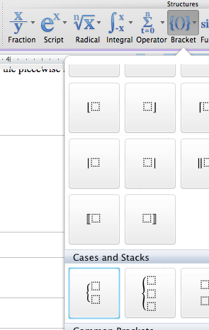

Hi, so I'm have a really frustrating issue where I can't seem to get an equation to align WITHIN an equation. I know that if I press shift + enter and ask it to align on a character that it will line up if I have multiple equations, but the issue I'm having is within a "stacked" equation with a brace on the left. I've attached a screenshot of what the resultant equation looks like currently. As you can see it's centering the top equation rather than left-aligning it. Try as I might, I cannot seem to get them to be left aligned. I've tried inserting a line break within the brace, but that doesn't seem to be working either. Any help would be appreciated.

    Thanks Joe, but as I tried to point out in my original message, that solution only works for me when I have multiple equations. The equation I pasted in the original message is a single equation using the "cases and stacks" option with the bracket structure. I need the brace on the side and can't seem to get it left aligned with the brace. I can only do it as two separate equations. I've attached an additional screenshot here, if that helps.
