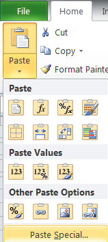

    2013-11-11T21:53:38+00:00
    Thanks Andy, Paste Link appears when I copy a block of text (RHS below), but not for a chart (LHS below).  Could there be something in my settings which causes this?
    2013-11-11T08:42:14+00:00
    @alexJJJ,
    In xl2010 copy and then press the Paste button on ribbon. The Paste Link option is icon bottom right.
    2013-11-11T04:07:51+00:00
    I've been all over the web looking for solutions to the same problem.. rescaling the axis in a chart on a protected sheet. No other solutions worked so far, and this was the most recent post I found.
    The dynamic image link is a nice suggestion ... but it seems to be referring to Excel 2007 and I dont have the option to "Paste as Picture Link" in Excel 2010 (V14.07106.5003).
    Is that option hidden somewhere that I can't see at present. ?
