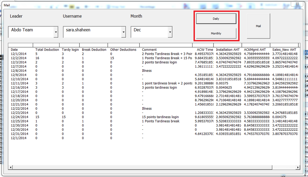

    Hello Ossie,
    i'm already solved the mailing issue via the above code, but this code use a fixed range of data to send it in mail body.
    to get the whole image, this table that i need to send is dynamic, because it's exported from a listbox data, these listbox controlled by two button to retrieve the range
    when hit "Monthly" the range restricted, when hit "Daily" the range expanded as per the filled source.

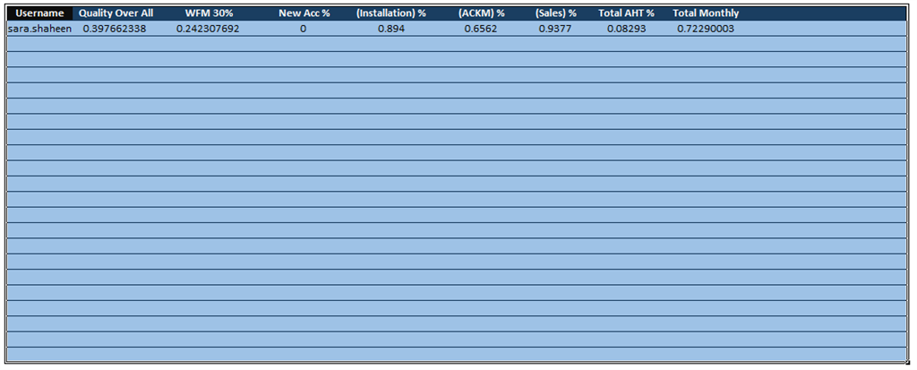

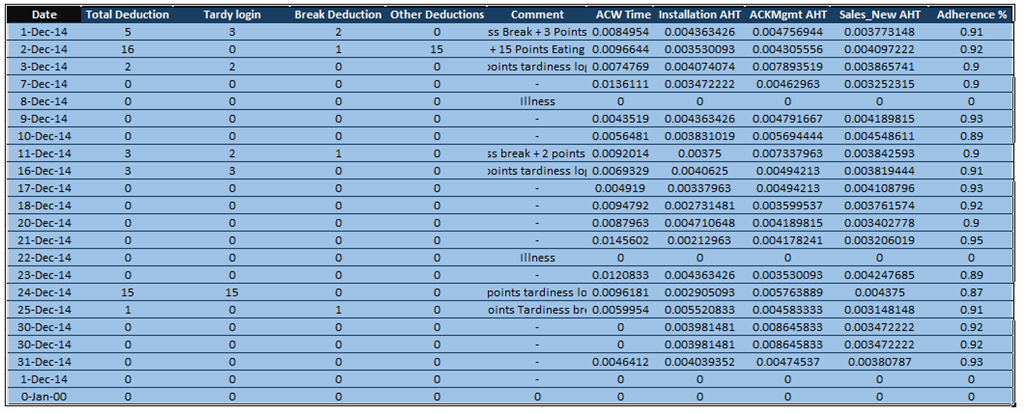

    these range is copied it to the range that i need to send via Outlook,
    when use daily the filled range is ("K11:U33"), this range isn't fixed may be end till U32, U30 as per the retrieved source
    but when click "Monthly" the table range restricted to be ("K11:S12")
      what i need is to adjust this line at the above mailing code
     Set rng = Sheets("Data").Range("K11:U33").SpecialCells(xlCellTypeVisible)
    need to set cell ("U33") to be the last indexed cell at the table, to be able to send filled cell only, instead of sending the whole table that may have a blank cell which isn't necessary to send
    i have uploaded the workbook.zip you cal call the listbox from "Interface" sheet, and the desired table located at "Data" sheet,
