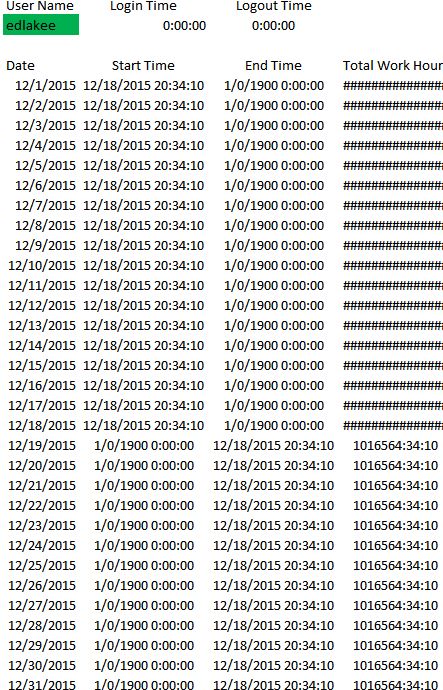

    2015-12-29T19:50:19+00:00
    Sorry i am unable to do so. Below is sample screen shot.
