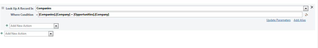

Open the Opportunities table in design view and create an OnInsert macro like this:
Look Up A Record In   Companies
     Where Condition    = Companies.Company=Opportunities .Company
     SetLocalVar
        Name varRating
        Expression = Companies.Rating
If varRating>"" Then
      EditRecord
         SetField
            Name   Opportunities.Type
            Value = varRating
      End EditRecord
End If
I tried to keep it simple here. You could and should do more If-checks about fields not being Null etc.

    Actually this is an access web app. I have read your blog and searched and the tables are related via lookup fields in the related table (https://support.office.com/en-us/article/Create-a-relationship-40c998dd-4875-4da4-98c8-8ac8f109b85b#\_\_create\_a\_relationship\_webapp)
    So I have a main table (companies) and a related table (opportunities). This opp table is related via company name in a lookup field to the companies table.
    There is a field in the company table called rating. When we make a new opportunity record, the rating value should be copied to the opportunity table field called opp.type by default. But this value can later be updated independently from the company.rating value.
    In other words, the opp.type field starts as the company.rating value on creation, but later may be changed. One company can own many opportunities with different types.
    From my limited research, it seems this should be done with an oninsert and maybe onupdate data macro. Is that the correct way?
    If so, what should the syntax be? I tried to do this, but it came up with an error when I tried to add a new opportunity record.
