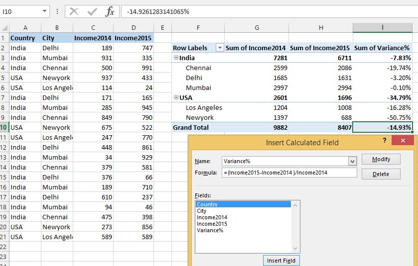

    2015-04-09T09:31:34+00:00
    This you can use in normal pivot table. Select your data/go to Tab Insert/Pivot Table  and then create a pivot table as per your need.
    Now while putting cursor on a cell in pivot table go to tab Analyse/Field,items & Sets/Calcuated Field and as per this screen shot create a calculated field.
    The formula used in my calculated filed is
    =(Income2015-Income2014 )/Income2014
